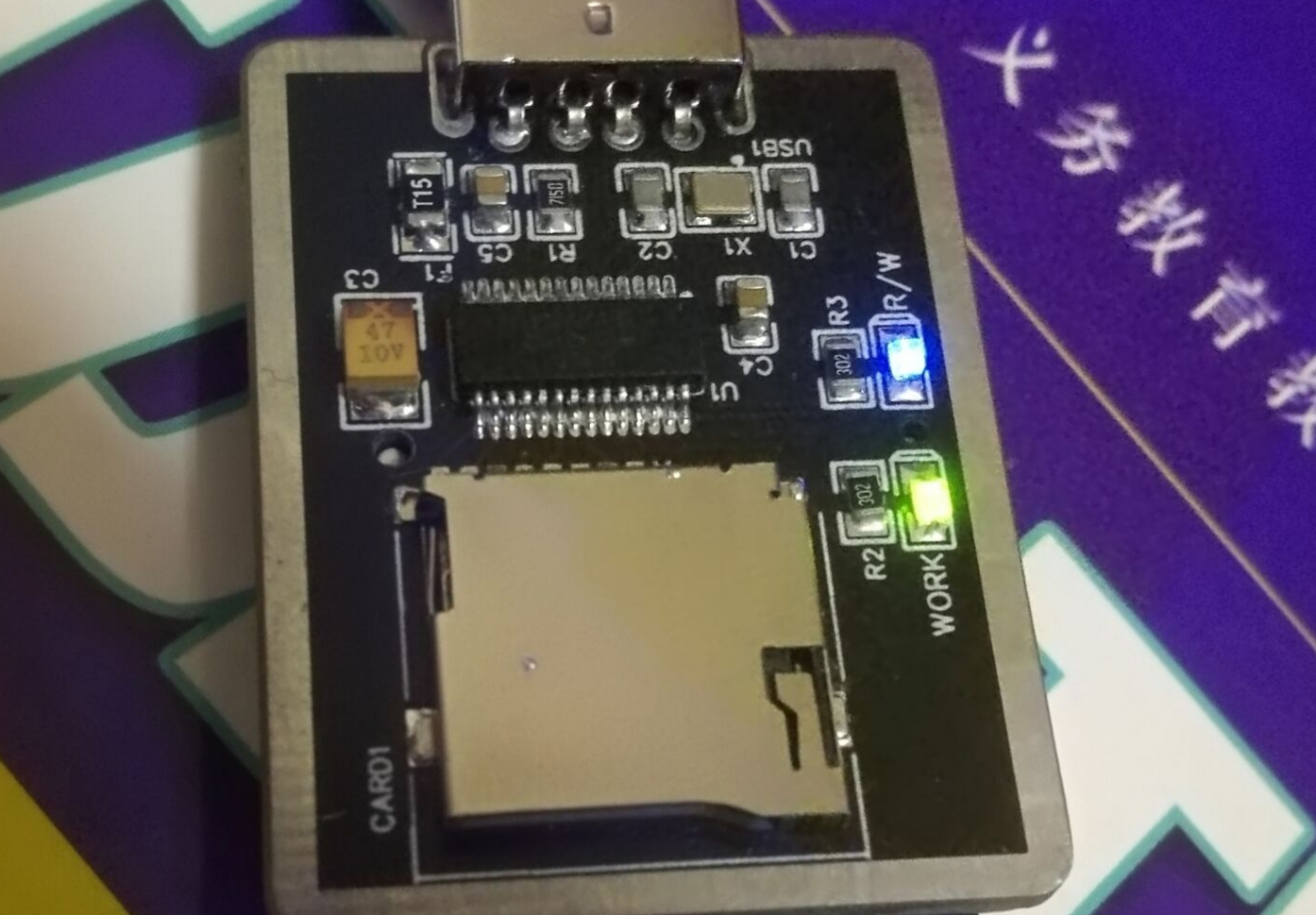

  • This project is based on the GL827L chip and supports read/write operations on SD and TF cards.
  • This module is equipped with an 8V1.5A self-restoring fuse, which can cut off the circuit in the event of overcurrent, short circuit, overvoltage, etc. to protect chips, memory cards, etc.
  • R4 is the SD card write protection switch and is not soldered by default.
  • The measured reading and writing speed can reach 20MB/s for reading and 9MB/s for writing.
Welding is completed and can be used normallyQQ picture 20200509151652.jpgQQ picture 20200509151656.jpg
Conducted speed test QQ picture 20200509151119.pngQQ picture 20200509150427.png
Suddenly I found a card reader with the same GL827L solution in my camera bag. I planned to test it and compare the reading and writing speed with the homemade card reader.
In order to avoid cluttering the entire project description, a comparison version with the SSK® card reader is placed in the attachment.
In contrast, the homemade ones are faster than the ones sold on the market, but the ones sold on the market are sold for 22.9 yuan, which really saves money.
