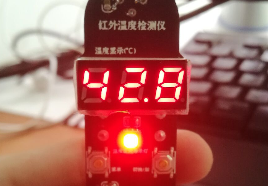

Function:
  1. Using Atmel Mega328P chip as the main control, based on MLX90614, with 3-digit 0.28-inch common anode digital tube display
  2. Powered by 18650 battery and boosted by IP5306 (since MLX90614 has 3V3 and 5V power supplies, please choose the corresponding LDO chip and buzzer)
  3. After 3 measurements, take the average to reduce errors.
  4. One-click measurement, response time is about 300ms
  5. Temperature compensation function: data is stored in EEPROM and saved when power off
  6. 3-segment temperature zone alarm function: divided into green, blue and red zones, no alarm will occur if the value is lower than the green zone setting, 5 beeps will be heard if the red zone set value is between the green zone, and 10 beeps will be heard if the value is higher than the red zone set value.
  7. Buzzer switch: you can set whether to sound or not

The forehead thermometer is at normal temperature. QQ picture 20210504143157.jpg At moderate high temperature. QQ picture 20210504143154.jpg At severe high temperature. QQ picture 20210504143151.jpg Mass of the forehead thermometer (only 19.8g without battery) QQ picture 20210504143148.jpg
