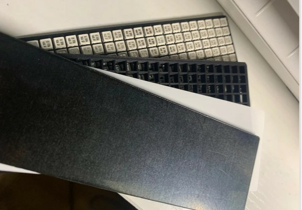

This project uses WS2816B full-color RGB dot matrix display and Qiyingtailun 1102 chip to realize voice control: real-time clock, temperature and humidity, smart night light, and FFT music spectrum functions.
exhibit
Layout
Note: 1. There are too many dot matrix screen components, and the standard version of EDA cannot meet the design, so it was put on the professional version of EDA.
    2. Use Huacai Micro WS2816B, full-color LED.
    3. [ There is still a small problem that has not been resolved. I don’t recommend cloning, I’ll solve it after I finish my postgraduate exams.
project instruction
This project is for learning purposes . Various demos have flashed in my mind before realizing the RGB full-color dot matrix display control.
1. Using Qiying Tailen 1102 chip as the main control, I bought CI-C22GS02S directly (1122 standard chip board);
2. The relative cost of this core board is about 12 yuan, but the open IO of the core board is too little;
3.1122 as the main control has 3 PWM ports, 2 serial ports UART1 (multiplexed with one IIC) and UART0;
4. The core board integrates a 4W power amplifier circuit and MIC circuit, and is directly connected to the 4Ω speaker and pickup electret.
5. FFT music spectrum input sampling requires an ADC, and the Qiyingtailun 1102 module does not lead to the ADC port.
Directly disconnect the 1.2V sampling port of the module and connect the flying wire to the ADC sampling port (as shown in the figure below).
