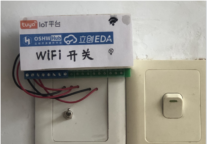

It can realize 6-way relay control. I originally wanted to use 7-way, but the board is too big and exceeds 10*10. So it was changed to 6-way. My original purpose was to control the lights, and it was simple and quick to use relays. Let's analyze the schematic.
The most fun thing is that it can be controlled directly with Siri, which is convenient.
First look at the actual picture
This is a relay welded and connected to test whether it works.
The switch is connected as a dual control, so that both the original button and my module can control the switch. Approximate drawings

How to use: Very simple, plug in the power, click the distribution button on the Changan board, wait until the indicator light flashes quickly and click on the Tuya app to discover the device. If you cannot connect, please use the hotspot distribution mode, which is available in the app Detailed explanation and introduction. This module only supports 2.4G routers.
