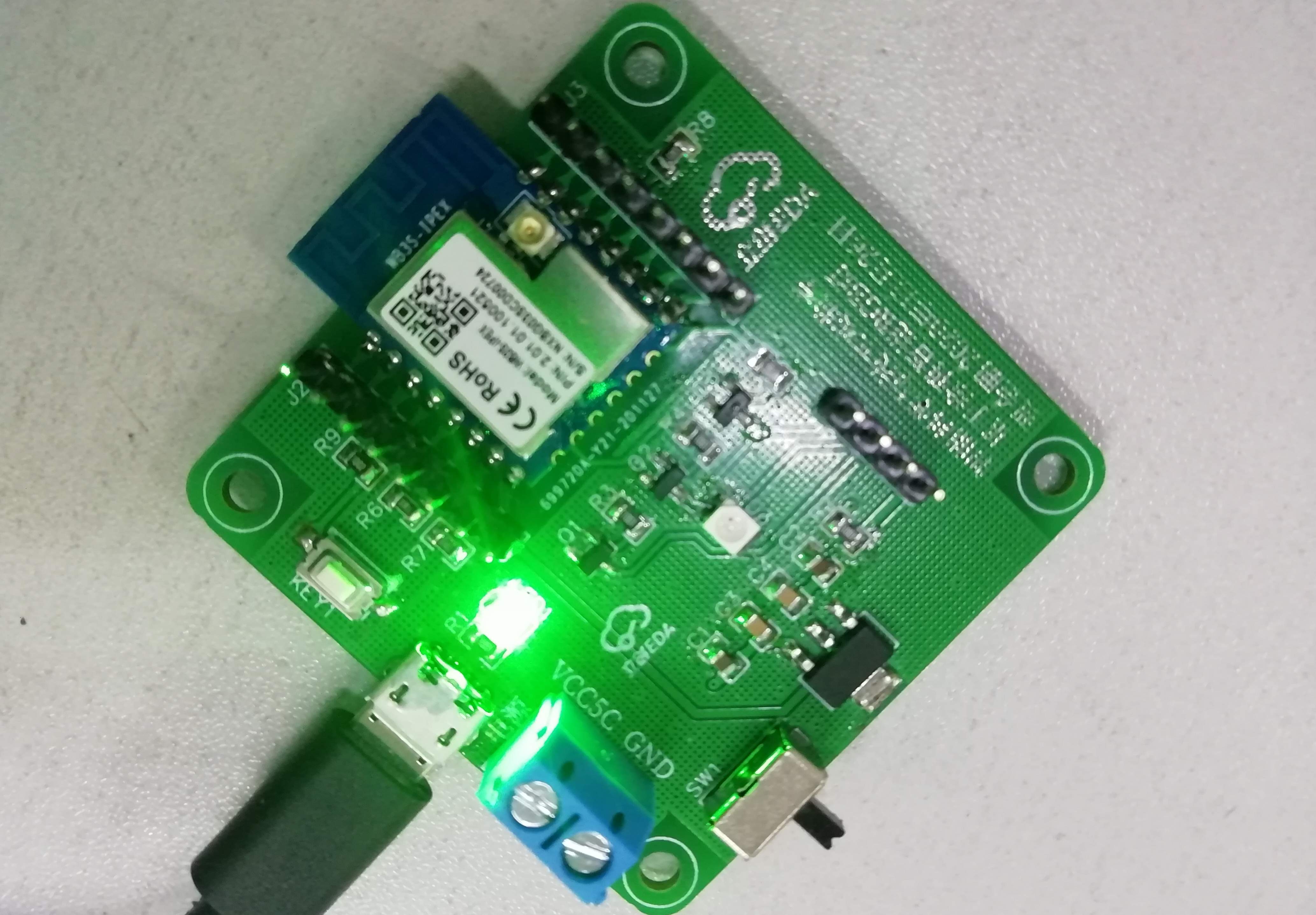

First, test the voltage of the welding power source to be normal, then weld the components and modules. After the welding is completed, check the solder joints and find the correct ones. Then you find that the light does not light up, and you start to feel depressed. . . . I thought my schematic was wrong,
At first I thought that the diagram for studying Mo Gong was incorrect, because many students used 12V. I was actually confused, which meant that I had to scrape off the copper foil, so I asked other students and checked the chip manual myself, and tested the flying leads. I found that RGB can light up using a voltage of 5V. The parameter screenshots are as follows, which proves that the lamp is not broken.
Using that field effect transistor can also be used at high levels through flying wires
Vgs is turned on, DS is turned on, and the RGB light is on.
Through troubleshooting, it was found that the module firmware configuration was incorrect.
An RGB is a three-way light, you can choose one path by yourself. I almost wanted to give up after looking at the time, because the module stocking was still slow, and at the same time, it was strange to have a module distribution network. It succeeded for the first time, but it kept failing after that. . , and therefore myself. . . But in the end, I used the module without welding to test it. The previously configured pins can light up a lamp. At the same time, the board module was successfully reconfigured, so that all three PWM signals required for the RGB lamp can be controlled directly. take off. . .cHxVJ8J659ZQNEo7sL564DZrIvBsyj68i7rkJVZb.png
I just use three modules to complete the functions of one module. . It’s a waste, but understanding the complex colors composed of the three primary colors is also another gain. .

The new module has arrived and the finished product is welded as follows:
