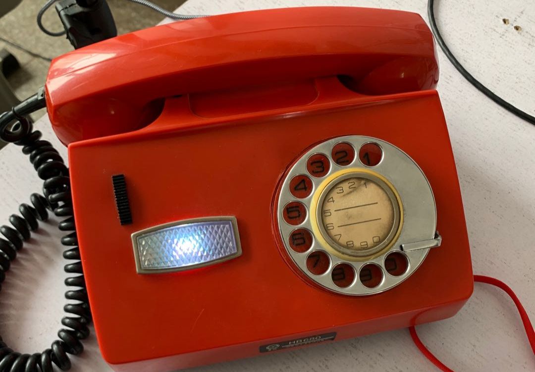

Elderphone firmware is used to drive old dial telephones to implement basic phone functions. The basic working principle is as follows:
1) Both ends of the phone provide 10V direct current through the DC-DC boost module. After 1/20 voltage division, the line voltage is detected. When the phone is on-hook, the detection voltage is about 500mV, and the line voltage is about 10V at this time. After off-hook, the voltage drops to about 3V, and the detection voltage is 150mV at this time. The detection port is ADC2
2) When the dial is rotated, both sides of the line are periodically short-circuited, and a dialing pulse is generated that is detected by GPIO9. When the number reaches 11 digits, or it is manually ended with half-dial mode, the call is made.
3) When an external phone is connected and the ring tone circuit is turned on, GPIO19 is set to high level to switch the line boost transformer primary to the 25Hz signal generator, and at the same time GPIO18 outputs a 25Hz square wave pulse driver to generate a ringing signal.

The same model of phone can be purchased on Xianyu. 1.jpg The system consists of two parts: software and hardware. The phone core board can be purchased by searching for Air724 phone core board on Taobao. The purchase link is: https://item.taobao.com/item.htm?spm=a230r. 1.14.16.7842a199WLhFUA&id=624610770134&ns=1&abbucket=10#detail The baseboard part drawings are completely open source, and there are currently no circuit boards for sale. The source files of the drawings and the hardware part baseboard&coreboard are provided in this project 2.jpg
