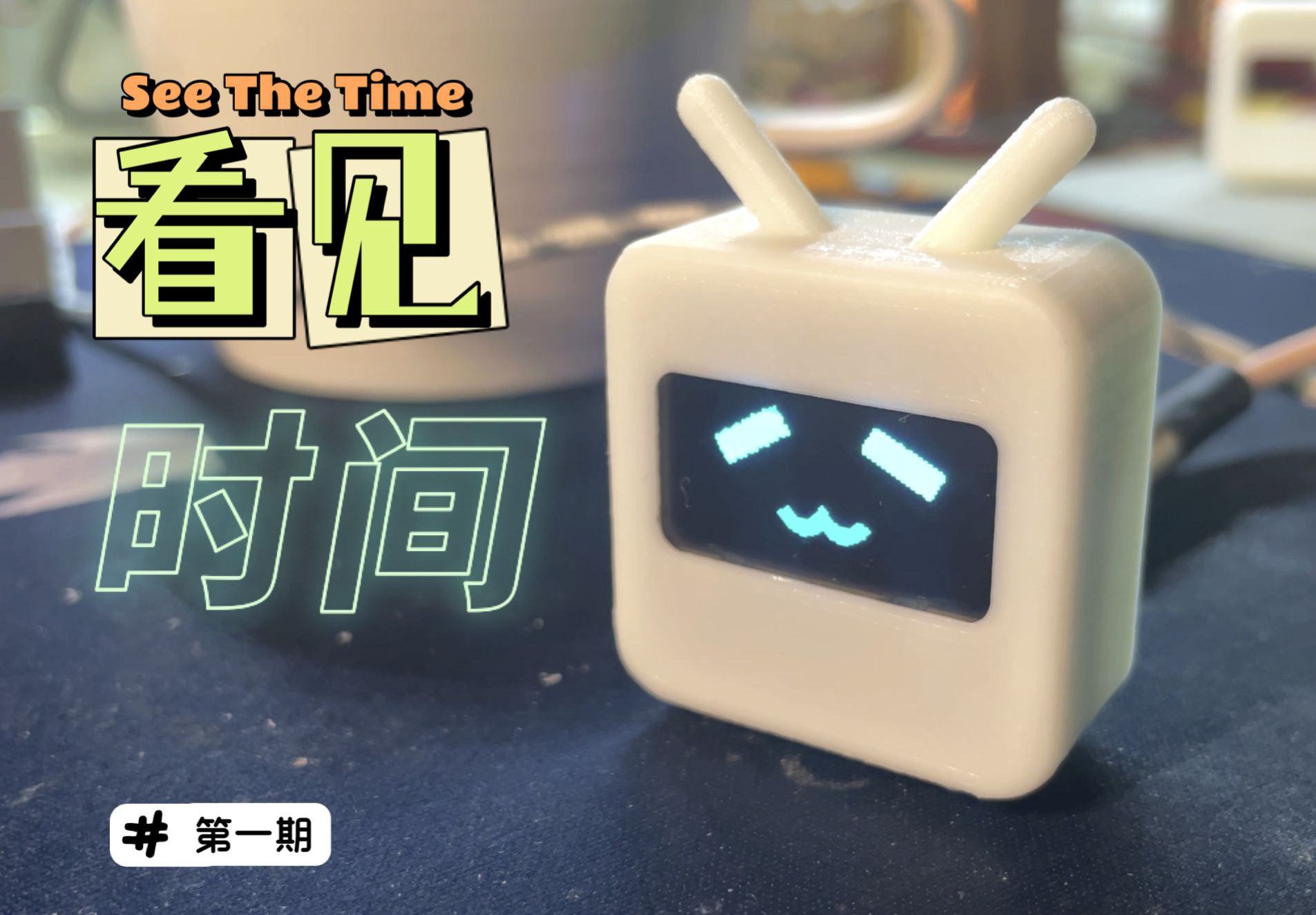

Small TV weather clock - just have your hands on it
Read the instructions, just have some hands on it!
Welcome to join the group and play with creative clocks: 779116675
Production video: [ Strive to be the cutest little TV at Station B ]
This project is based on the open source project [ 0.96 OLED Network Weather Clock ]
Modify and add content:
1. Added web configuration parameters, you can configure weather region, weather key, page selection and other parameters through mobile phone or computer! ! !
2. The PCB is simplified and only a few electronic components are needed to implement it. (DHT11 and U2 do not need to be soldered, they are reserved interfaces)
3. The shell is drawn. This version of the shell is suitable for printing with FDM printers.
4. Added countdown function, added a weather interface, and added emoticon animation
statement :
The hardware part of this project including the shell is prohibited from use for any form of commercial purposes (including but not limited to publishing on for-profit websites)! ! ! The code part follows the open source agreement in the original project!
Precautions:
1. For the ArduinoJson library used in the source code , please use version 5.13.5; ~~~~
2. Please purchase the old version of the screen. The 0.96-inch OLED screen size is shown in the picture;
3. If you don’t know how to use ArduinoIDE to develop ESP8266 (please use version 2.74, see the attached picture), please use Baidu or refer to the content in the original project, or watch the video on Station B.
4. The program download uses the USB to TTL module, please tb by yourself (the motherboard must be powered separately when downloading, and the downloader can only be connected to GND, RX, and TX)
5. In addition to uploading the program, you must upload data (refer to the original project method or Baidu) before you can see the configuration interface.
Instructions for use:
1. The weather source uses Japanese weather, please apply for the Key by yourself (if you don’t understand, please use Baidu)
2. A QR code appears when you turn on the phone, scan the code to configure the network. If there is no response, please connect to wifi_link_tool manually, and then enter 6.6.6.6 in the browser to enter the network configuration page.
3. After the network configuration is completed, enter the IP of the small TV on your mobile phone or computer (you can see it when you turn it on) to enter the setting interface (it needs to be in the same LAN as the small TV)
4. Reset the network: When the computer is powered on, press and hold the Boot key for 5 seconds to reset the network.
5. If you encounter various unexplained problems, please use the ESP download Tool (official download tool) to erase the Flash and then download the program again.
