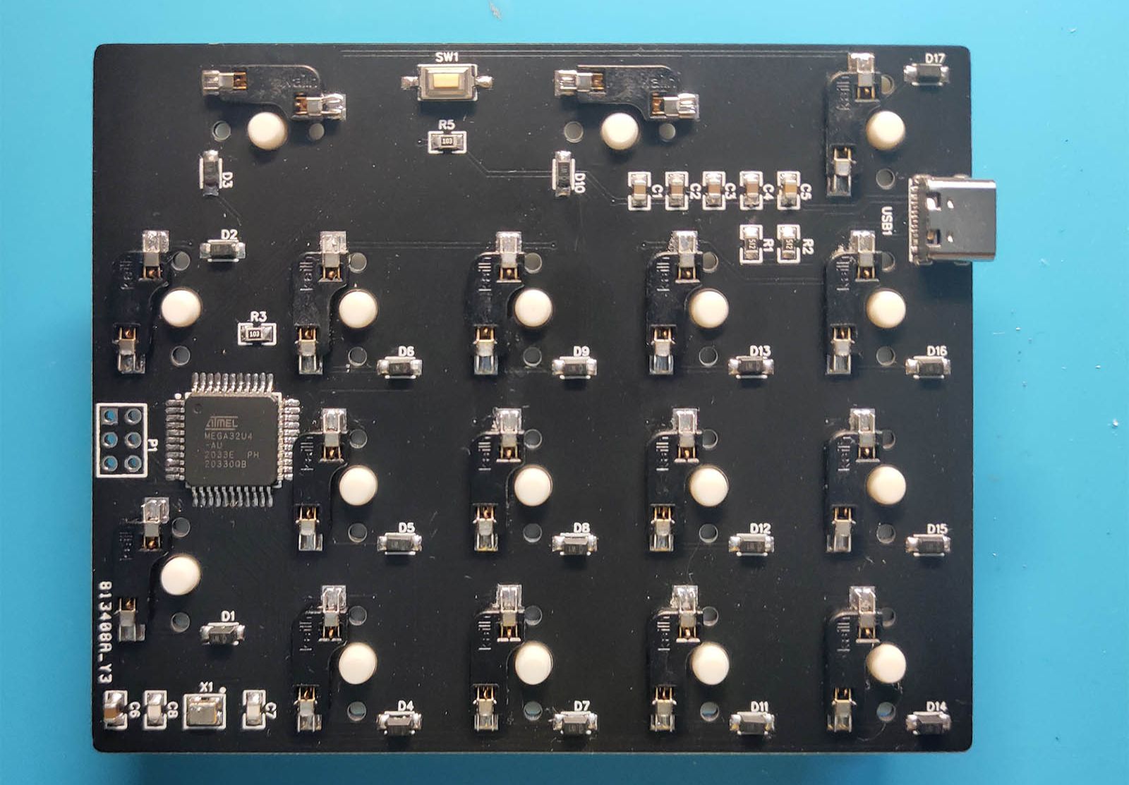

Modified on the basis of https://oshwhub.com/lkaill/wu-xian-jian-pan-chong-dian-wen-, and changed it to a standard layout. I forgot to open the holes for the pcb satellite axis and can only use steel plate satellites . The shaft (of course it can be used without it), D+D- are not equal in length, so it is no problem to use, and serious children's shoes can be modified by themselves.
