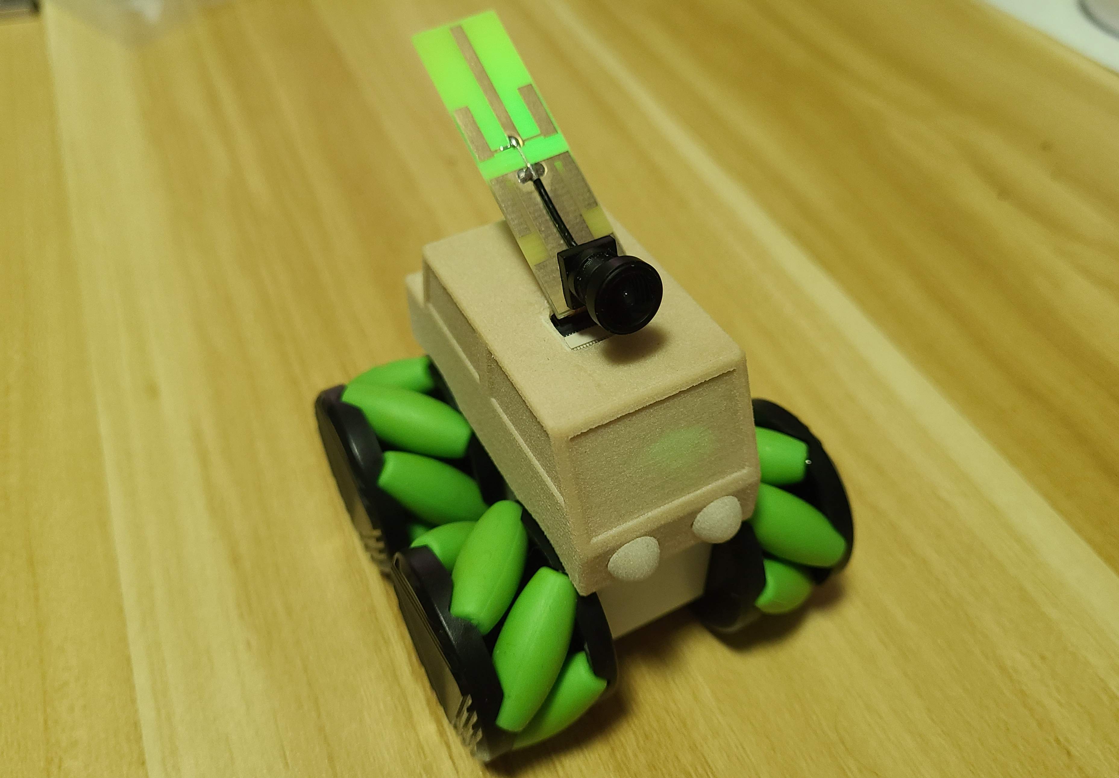

The mini wheat wheel reconnaissance car coincides with the Li Chuang event, and the spare parts in hand can be used to build such a car. For the first time, I experienced the one-stop service of Lichuang EDA->Jialichuang PCB->SMT.
Project function introduction
Control the car to move in all directions through the joystick of the mobile phone app, and have a wide-angle lens to monitor objects and road conditions ahead in real time.
  • The main control of the car uses the esp32cam module and an external antenna;
  • The IP5306 power management module is used to achieve 2.1A charging and 2.4A discharging. The many features of IP5306 make it very suitable for this car. (Suitable charging and discharging current; esp32cam does not have redundant io driver LED to display power and buttons; the automatic shutdown feature below 70ma is just the trigger for esp32cam to close the camera, without using the IO port, to achieve remote software shutdown, etc.);
  • Use two 102535 batteries in parallel (no protection board), 2000mah large battery;
  • It adopts type-c interface and supports cc and ac cables.
  • Use the design of stacking up and down boards (in such a small design size, one plane cannot fit all the devices. There happens to be a module like esp32cam, so you only need to draw another expansion board);
  • Use DRV8833 motor driver chip to drive N20 DC motor;
  • The car shell is assembled without screws and buckles, and incorporates some elements of a machine box to prevent disassembly by children;
  • The car's integration level is very high. The battery, motor, PCB, and casing are almost all tightly fitted, leaving no extra space.

The structure diagram is as follows (Mai Lun modeled it lazily, just look at the size), and there is a discrepancy between the camera and the actual picture above. Because there was a mistake in modeling the housing, because the antenna was initially designed to be inside, and an ordinary camera was used, but the effect was found to be poor. So the casing on the camera was cut off directly, so you can barely see it. . . And finally I used a wide-angle lens (on the one hand, the wide-angle viewing angle is large, and on the other hand, the esp32cam’s built-in camera CMOS is vertical. I wanted to take a banner picture, and I happened to have a 120° wide-angle lens, which I tried and it was suitable). The camera cover is to be built as a separate part to adapt to different lenses. My shell proofing business took a long time, and I only had to wait a week this time, so I will wait until the 3D model of the shell is completed later (it will take a long time, because I also want to design a high-looking appearance, this version of the shell There is no decoration, the car light is not actually decoration, it carries 3 functions).
