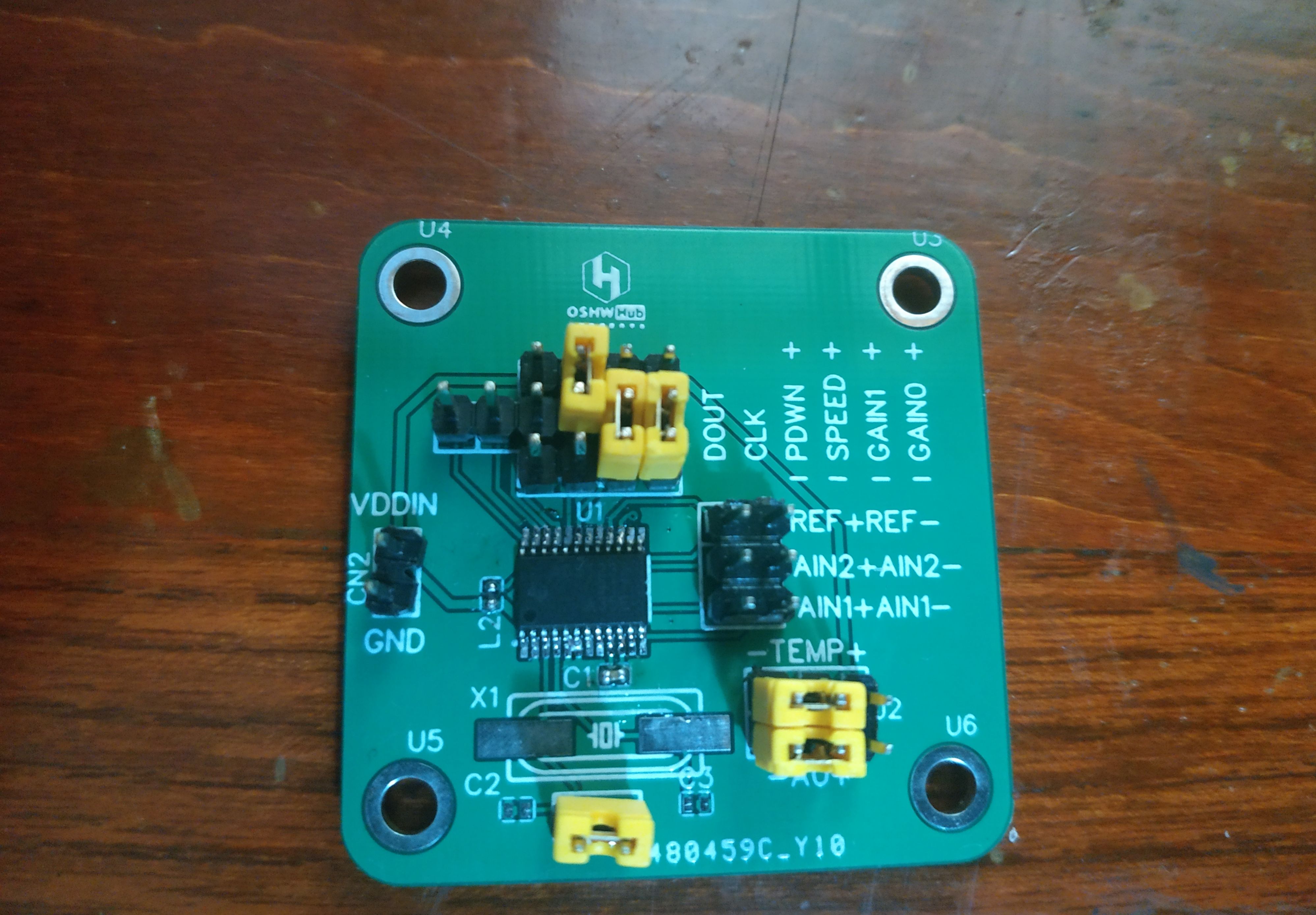

This is a 24-bit differential input ADC solution verification board. The chip uses TI (Texas Instruments) ADS1232. This is a 24-bit differential input analog-to-digital converter. Features:
  • Low noise, 17nV when working at 10SPS, 44nV when working at 80SPS
  • Built-in low-drift oscillator, 3% error, optional external oscillator
  • Optional gain is 1, 2, 64, 128 times
  • External reference voltage up to 5V
  • Built-in 2 differential inputs with temperature sensor
  • Simple digital serial interface
  • The supply voltage is 2.7-5.3V
  • Temperature range -40°C to 105°C
Typical applications: weight scale, strain measurement, pressure sensor parameters.png Typical application example circuit: For the weight scale Weight scale application.pngFront.jpgBack.jpgtest, I used the STM32F103 development board, and the wiring method is as follows:
  • SCLK=====PA6
  • PDWN=====PA5
  • DOUT=====PA4
