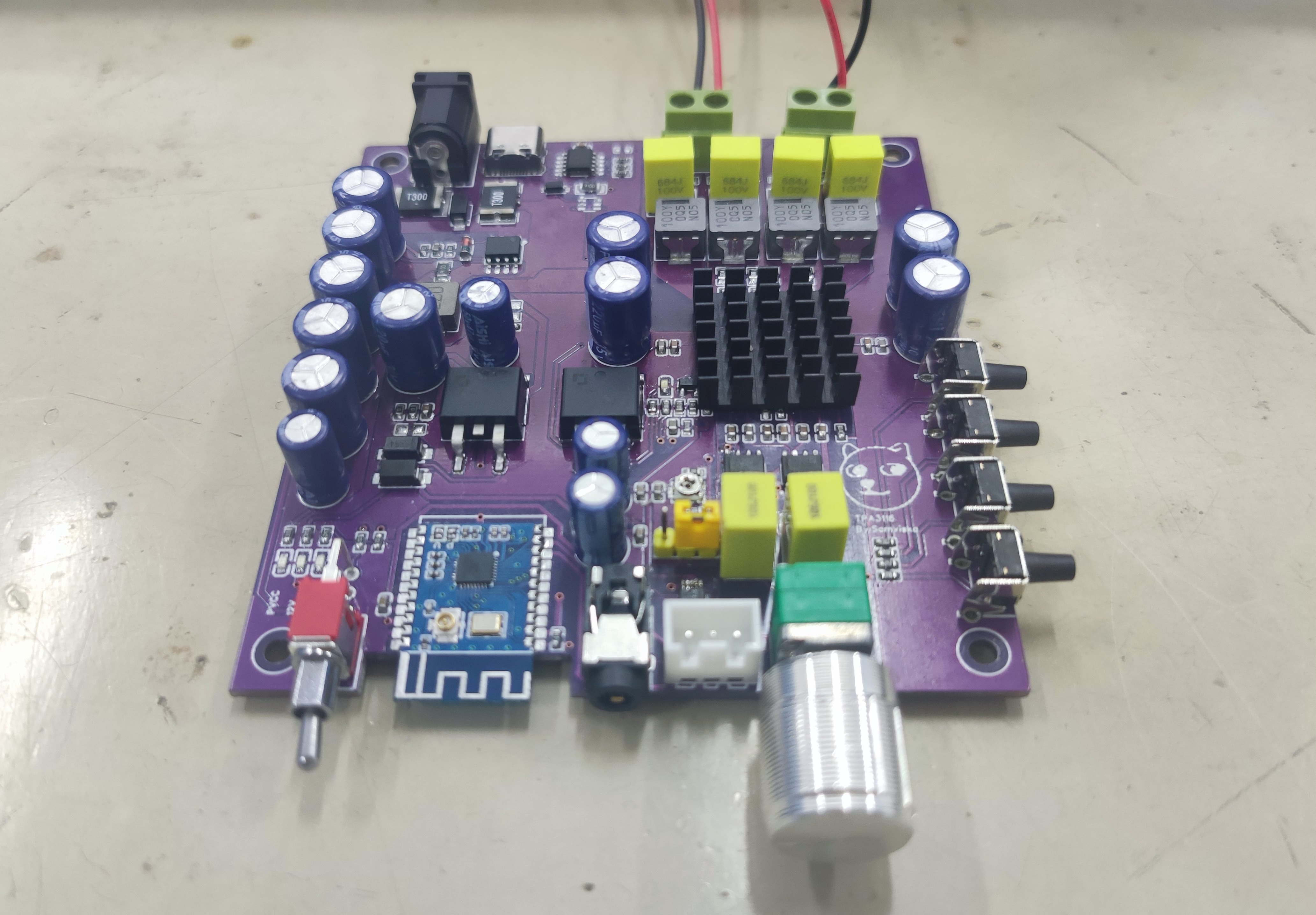

# Sixth Lichuang Electric Competition#Audio amplifier+Bluetooth
1. Introduction to project functions
Bluetooth + power amplifier board, using PD induction or DC port power supply 12V-24V
Two audio input options, automatically switching audio sources (Bluetooth has the highest priority)
TPA3116, Jerry Bluetooth module
2. Project attributes
First public release, not entirely original
3. Open source agreement
GPL 3.0
4. Hardware part
Use CH224K induction chip, when R2 is not connected. Decoy 20V voltage.
Jerry Bluetooth 5.0 module, when Bluetooth is connected to the device, the LINK pin outputs high level
CH442E, video and audio signal switching module.
The purpose of selecting the signal source is achieved by configuring the IN pin level (LINK pin of the Bluetooth chip)
TPA3116 module + preamplifier, refer to the circuits of many open source experts and the official development board circuits
