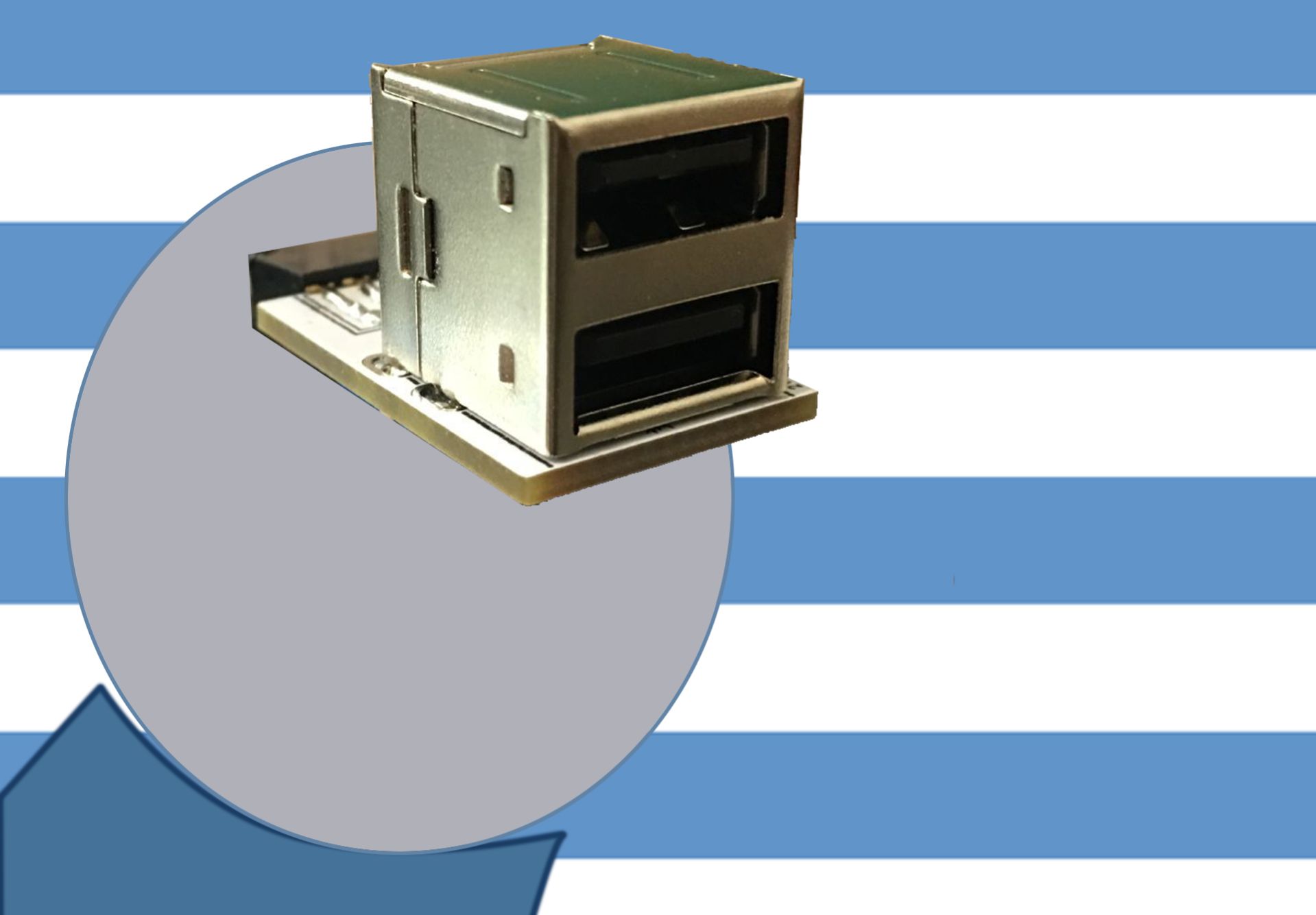

[Successful test] Motherboard USB2.0 9pin adapter
  • Using this adapter, you can directly convert the 9-pin socket of the motherboard ( almost any motherboard ) into 2 USB2.0 sockets!
  • It is very convenient for you to use the USB2.0 data cable to connect to the USB2.0 panel on the front of the chassis!
  • At the same time, a USB flash drive can also be built into the chassis . (Applicable to situations where some industrial computers, Synology and other machines require U disks to be plugged in at all times)
  • You can also put a wireless mouse and keyboard into the case, making full use of the idle interfaces in the case without occupying external interfaces, which is beautiful.
  • usb female connector           purchase link
  • The measured speed is the same as that of native USB2.0. The speed does not reach 40mb/s, which may be because the test platform is too old.
  • Note that in order to save costs, low-cost universal female headers are directly used, so there is no fool-proof design . Vertical lines are drawn on the silk screen of the fool-proof bits on the PCB . It is recommended to use a soldering iron to flatten the fool-proof bits or block them with something when welding.
  • The fool-proof bit in the uploaded picture was reversed and has been corrected.
