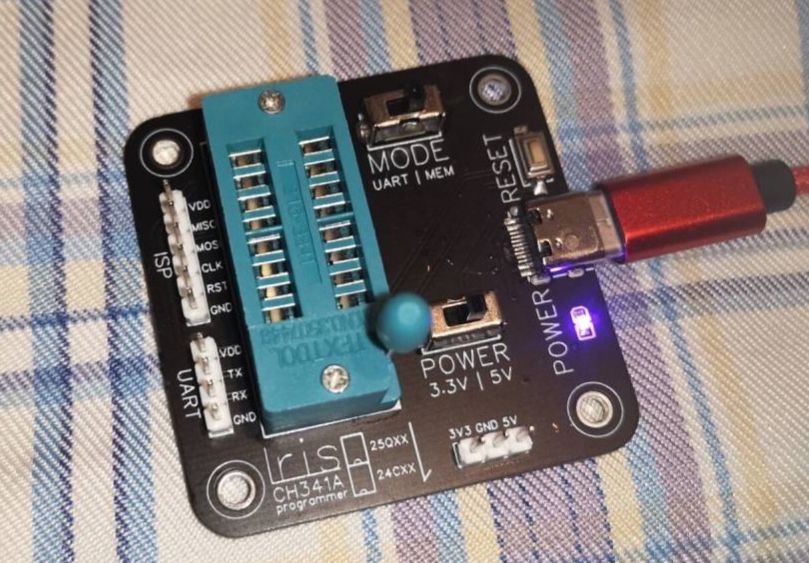

[Group A label MEM] Programming of 24Cxx and 25Qxx
[Group B label UART] USB to UART, ISP
The two groups of functions are switched through the MODE switch . The 5V/3V3 power supply can be switched through the POWER switch (acts on all pin headers marked VDD on the board and the locking socket ), and can provide two voltage outputs at the same time (the 5V and 3V3 pin headers under the switch).
Form Factor: Iris Cube Basic Small ( https://oshwhub.com/Iris-Cube/ICBasic )
This is the first generation of mysterious unstable bugs
