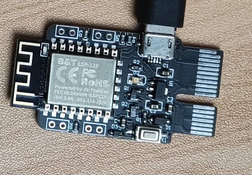

The computer remote boot card is convenient for people who manage computers remotely.
Streamlined circuit and simple WeChat applet control.
QR code:
Lianlian boot card QR code
  1. Scan the QR code on WeChat, connect the USB cable (do not plug it into the computer motherboard first), press and hold the button for more than 3 seconds (if you have never configured a network, you don’t need to press it when you power on the network), release the button after the LED flashes , enter the SSID (note to select 2.4G) and WiFi password and click Next. After the network configuration is successful, remove the USB cable.
16031241658011603124165799
  1. Wiring diagram (note that the power-on switch is not divided into positive and negative, and the power LED must be divided into positive and negative, and must be connected properly, otherwise the current computer power status cannot be measured correctly, resulting in misjudgment)
  2. After the network distribution is successful, a message indicating that the switch card installation is complete appears on the home page.
