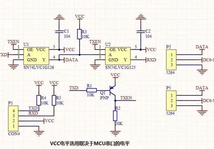

This project is a Feite steering gear TTL signal conversion board.
The schematic diagram is drawn with reference to the official information provided by Feite, see the attachment [TTL.jpg]
Used to drive 2 SCS009 servos and 3 SCS215 servos,
Because the total locked-rotor current of the five servos is approximately 1A*2+2.5A*3=9.5A,
Therefore, the buck module is not used, and a 2S lithium battery is planned to be used directly for power supply.
