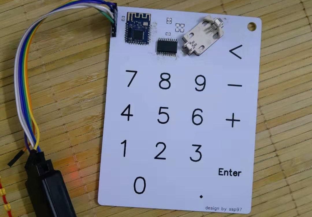

Touch bluetooth keypad
  • Bluetooth keypad implemented using CC2541. The Bluetooth module uses JDY-08 module, and the touch chip uses BS8116A .
  • You need to use TI's SmartRF04EB emulator for programming.
  • The code project is in the "BLE-CC254x-1.5.0.16Projects leHIDEmuKbdCC2541DB" folder in the compressed file.
  • It cannot be held and touched, and cannot be placed on tables made of certain materials.
