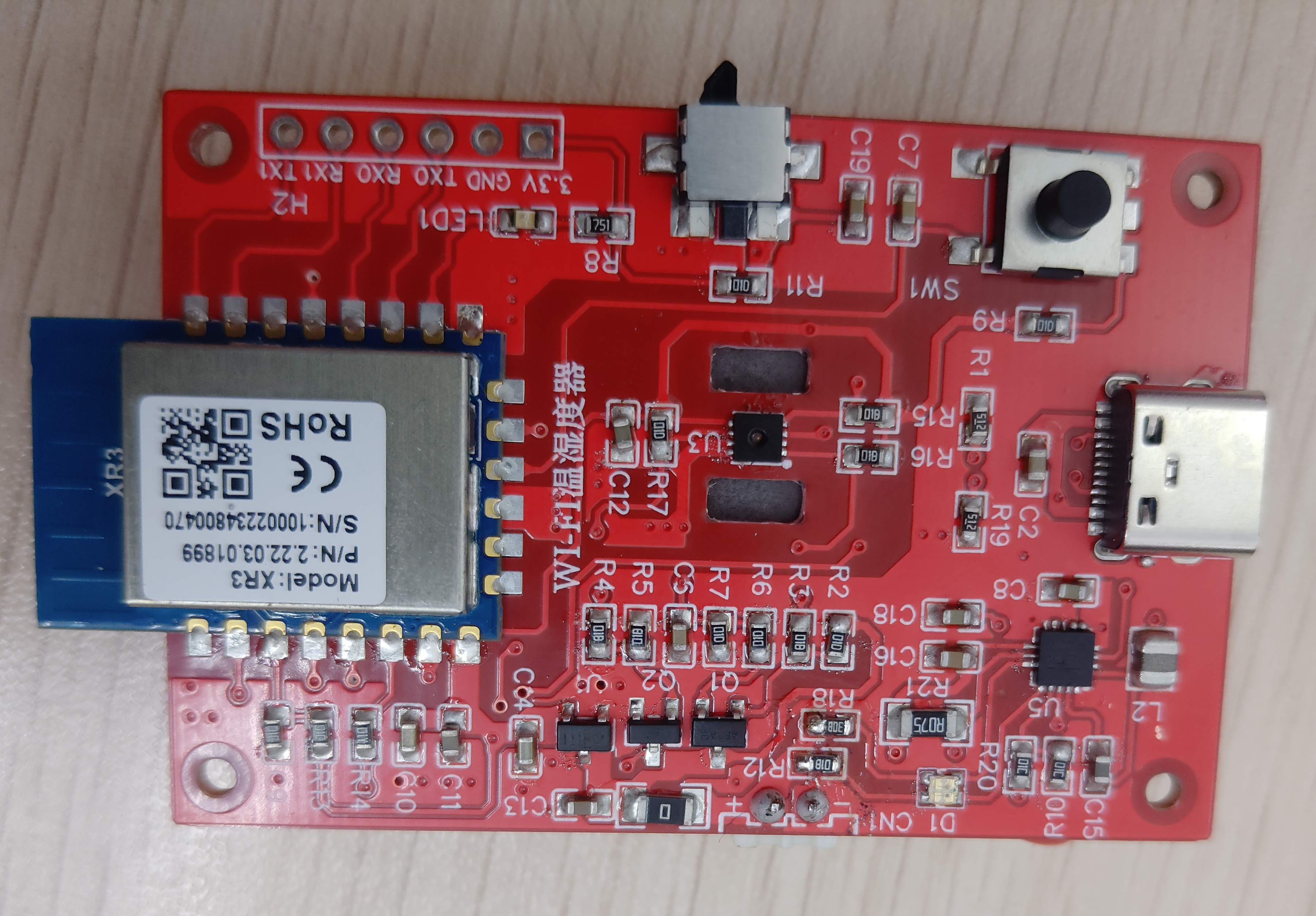

Temperature and humidity sensor based on Tuya XR3-WI-FI module programming-free design, the circuit is powered by lithium battery, typec power input interface and charging circuit. After the module is successfully configured, the Tuya APP will automatically register the module. If the connection is successful, you can see the display in the APP. The working status of the circuit is: after the network is successfully connected, the module enters the sleep state (LED1 is off), and wakes up regularly to report data (LED1 is on when waking up). ), the APP can view it (the wake-up time is 1 hour, and the temperature and humidity data are updated every hour). Video address of the work: https://b23.tv/goRy7Y
