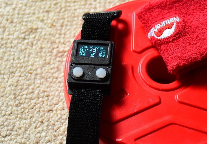

       Counters that are more suitable for one person to use. Most of the counters currently on the market need to be hung around the neck if used by one person. If you want to operate them, you must hold them with your hands to press them. They also use cheap LCD segment code screens, which can be used under sunlight or Can't see clearly at night.
       The main feature of this design is that it is designed in the style of a watch. With the quick-release elastic strap, it is especially suitable for one person to use for fitness, running and swimming. It uses two silicone physical buttons that feel great, making it easy to operate with one hand during exercise. It is also equipped with a Hall sensor, which will automatically count as long as it is close to the magnet during the stopwatch counting process. It can be fixed on various fitness equipment for counting.
       There are five functions in total: stopwatch, metronome, countdown, circuit training, and clock date.
Stopwatch function: Another feature is the design of a very detailed stopwatch recording function, which can record 4 groups of 255 times each, a total of 1020 groups. Each group provides a statistical interface, including the longest and shortest time, average time and total time. Each group covers the records cyclically, and uses the timestamp as the search directory for easy viewing. Usage scenario: Place the counter on the shore when swimming, and press the counting button after each trip. Swim 6 times as a group, and record the time each time and count which trip is the longest and shortest, the total time and Average trip time.

Hardware: STM32 40MHz processor 0.96- inch OLED screen 200mAH lithium battery ultra-low power Hall sensor RGB indicator buzzer
3D printed nylon material shell is wear-resistant and high-temperature resistant
Ultra-low standby power consumption can theoretically last for 1 year when fully charged and can be used continuously for 10 hours. USB charging, charging to 80% takes about 1 hour.
