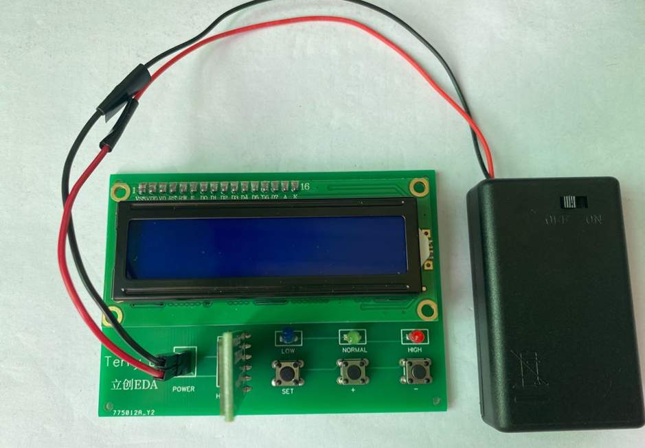

The complete physical picture of the portable temperature measurement system is as follows:
the blue, green and red LED lights are named "LOW", "NORMAL" and "HIGH" respectively, representing low temperature, normal temperature and high temperature. The functions of the three buttons are to set the temperature threshold, increase and decrease respectively. The LCD screen, Bluetooth module and power pin header are removed, as shown in the figure below:
The overall system block diagram of the portable temperature measurement system is as follows:
The temperature measurement system is powered by three AA batteries, and the microcontroller collects temperature information through the temperature sensor and displays it on the LCD in real time on the screen and simultaneously transmitted to the computer through the Bluetooth module. When the temperature is high, the red light lights up and the buzzer sounds long; when the temperature is normal, the green light lights up, and when the temperature is low, the blue light lights up. The temperature threshold can be modified by pressing the key.
