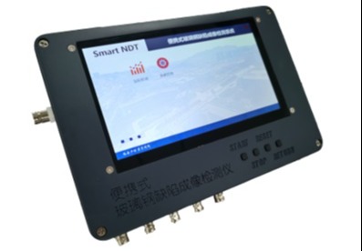

        The detection system takes on-site defect detection and health assessment of in-service FRP storage tanks, pipelines and towers in the petrochemical industry as a typical application scenario. It utilizes the characteristics of the coplanar capacitive quasi-static edge electric field in capacitive imaging technology that is sensitive to internal defects in non-metallic materials, and can effectively Detect superficial cladding damage of glass fiber reinforced materials ( GFRP ) and its composite materials, such as fiber delamination and bubbling, internal cracking and leakage, glue layer debonding and other typical forms. During the detection process, it has the characteristics of no contact with the surface to be tested and no coupling agent required.
        The system uses STM32 microcontroller as the core and has wireless network communication capabilities; the operation adopts dual control methods of touch and independent buttons, which can effectively prevent accidental touches. A complete signal processing system is designed for defect detection needs, including signal generators and acquisition cards, transimpedance amplifiers, quadrature lock-in amplifiers and supporting power systems, which greatly improves the completeness and integration of the system. Compared with traditional Capacitive imaging equipment has achieved smaller size and lighter weight. The system implements the real-time display function of defect signals based on the TouchGFX graphics framework. It adopts dual display of amplitude and phase information, which enriches the information sources and reduces the defect misjudgment rate. The lightweight cloud server is built based on the Flask framework to implement two-dimensional and three-dimensional rendering functions of defect images. The defect data is automatically uploaded to the cloud server after preliminary processing by the system. After verification by the server, it is sent to the target browser, where it is normalized on the browser side and rendered on the web page in real time. The web page can be logged in remotely to realize expert collaboration, batch and time-sharing online consultation functions. Data is automatically backed up on the server side, supports remote downloading, and ensures that defective data is reusable and traceable.

        The system uses STMicroelectronics' STM32F7 high-performance microcontroller as the core, has network connection capabilities, is equipped with a 7- inch touch screen, and is operated through the TouchGFX graphical interface. The hardware system is divided into a master system and a slave system based on target functions and business logic. The master system is based on the STM32F7 microcontroller, and the STM32F7 microcontroller core board and F7 core board backplane are designed around human-computer interaction requirements ; the slave system is based on the STM32G0 microcontroller. , around the sensor signal processing requirements, a signal generator, transimpedance amplifier and lock-in amplifier were designed. Experimental results show that this work can better detect superficial defects in fiberglass composite materials and has broad application prospects.
