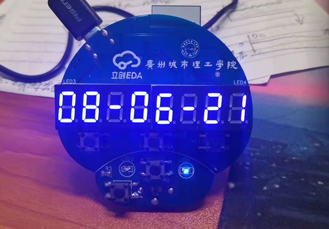

The main control is the ESP32-C3-12F module of the ESP32-C3 series;
  • Use two 4-digit common positive digital tubes as display;
  • The DS1302 clock chip serves as the RTC clock to ensure accurate time when the network is disconnected;
  • Onboard USB to TTL serial port circuit, no need for external serial port programming;
  • Three time setting buttons, two programming setting buttons,
  • DC 5V power supply. WeChat picture_20211101003911.jpgWeChat picture_20211101113831.jpg
