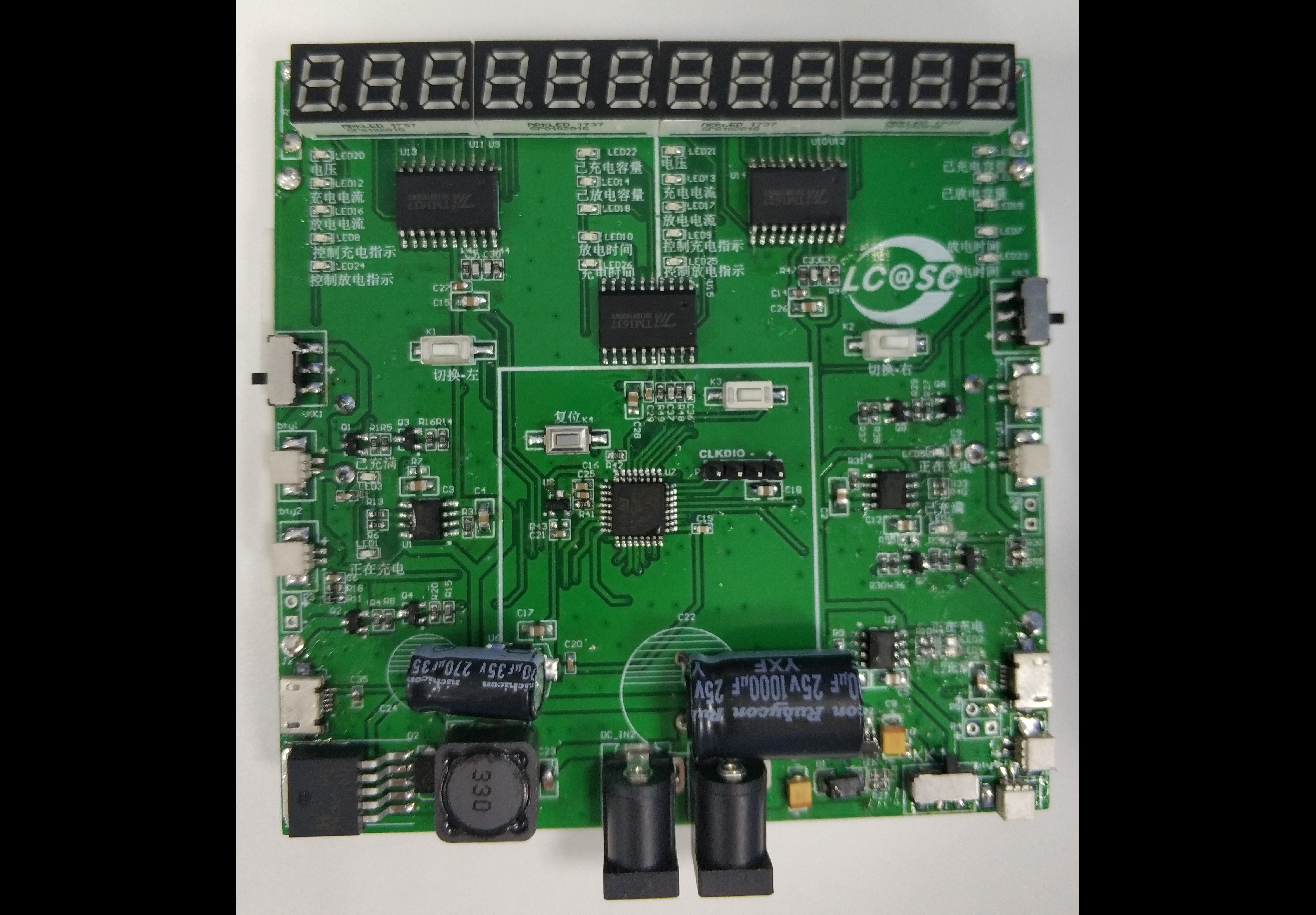

5.1. Pictures of the front and back of PCB (specially made with a big logo)
< br> image.pngThe following is a picture of the actual welded object:image.png
5.2. The files to upload other pictures of the project are image.pngimage.png* 6. Demonstrate your project and record it as a video for uploading
