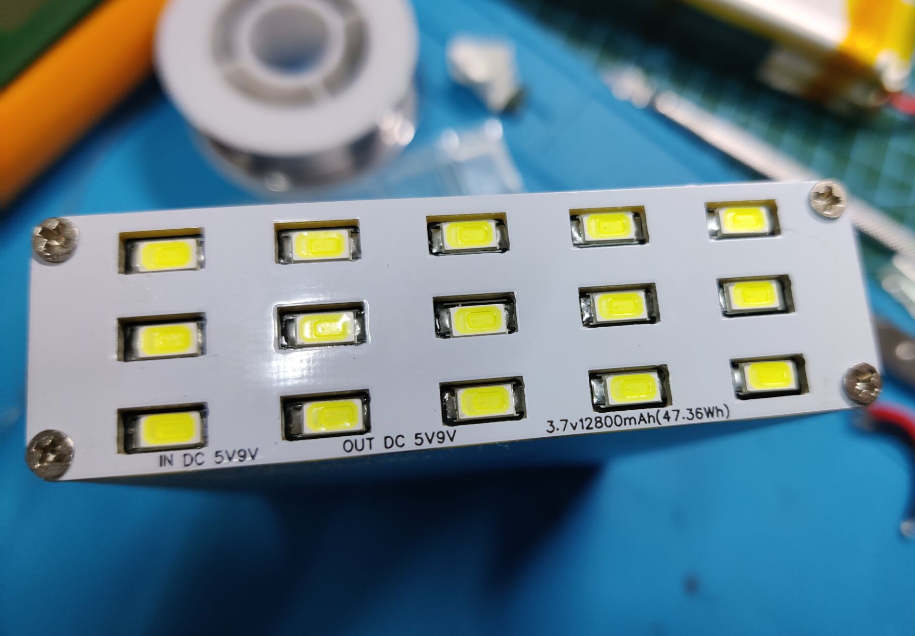

This project is the light panel of the 5358 power bank project
The driver chip is AP3032KTR-G1
15 pcs 5730 high brightness LED lamp beads
Input voltage 2.7~9V

new version update:
1 Solve the problem of stroboscopic when controlled by the power bank chip (the light board itself has no stroboscopic, it is the stroboscopic caused by the button detection signal of the power bank chip)
2 Appropriately reduce some LED lamp beads (the previous version used too many LED lamp beads, the chip cannot be used, and the full power of the lamp beads cannot be used, which is too wasteful)
3. The panel of the light panel can also pass the automatic review of Jialichuang.
