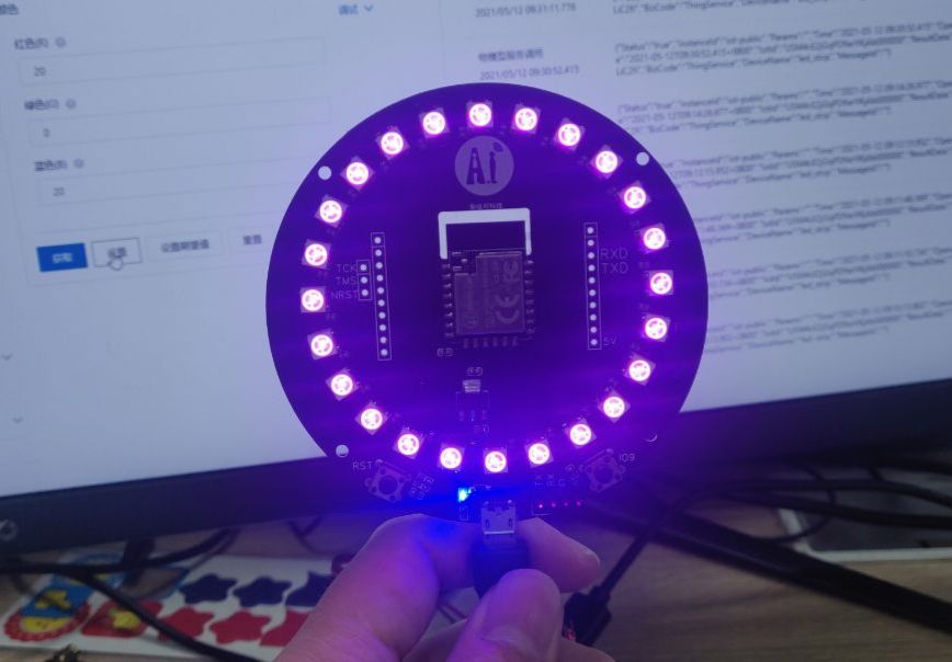

I believe if you still remember, I have previously posted a project for ESP-C3F to control WS2812. In case you have forgotten, I will remind you now: Anxinke ESP32-C3 module Alibaba Cloud remote control WS2812RGB light strip (based on ESP- IDF SDK) . The hardware part of this project was not shown to everyone until the end. That’s because the blogger didn’t want to show the Syrian-style wiring to satisfy everyone’s curiosity, so I took a photo: Insert image description here It’s in the debugging stage. It was so ugly that I didn't send it out. I finally finished debugging it today and made some changes. The effect is pretty good.

The blogger used 24 WS282 lamp beads. Each lamp bead has a decoupling capacitor to prevent the lamp beads from interfering with each other. The lamp beads are connected in parallel (this component arrangement can be automatically generated). Insert image description here

Insert image description here For convenience, the blogger arranged the lights in a circular array, and everyone can place them in various shapes according to their own aesthetics.

4. Physical display
Insert image description hereInsert image description hereInsert image description here

Make sure the wiring is correct:        (1) USB has power input;         (2) TX, RX and G are correctly connected to the USB to serial port module. After the board is powered on, press and hold the ==IO9== key, then press the reset button. After releasing the reset button, the module can enter the download mode:
Insert image description hereInsert image description hereNote: Because the lamp beads are connected in parallel, the marquee effect cannot be achieved for the time being! ! ! ! Corresponding source code address: https://gitee.com/seahi007/ESP32-C3ControuWs2812 programming related blog post: Essink ESP32-C3 module Alibaba Cloud remote control WS2812RGB light strip (SDK based on ESP-IDF) project file is in the attachment, please Open it with Lichuang EDA Professional Edition! !
