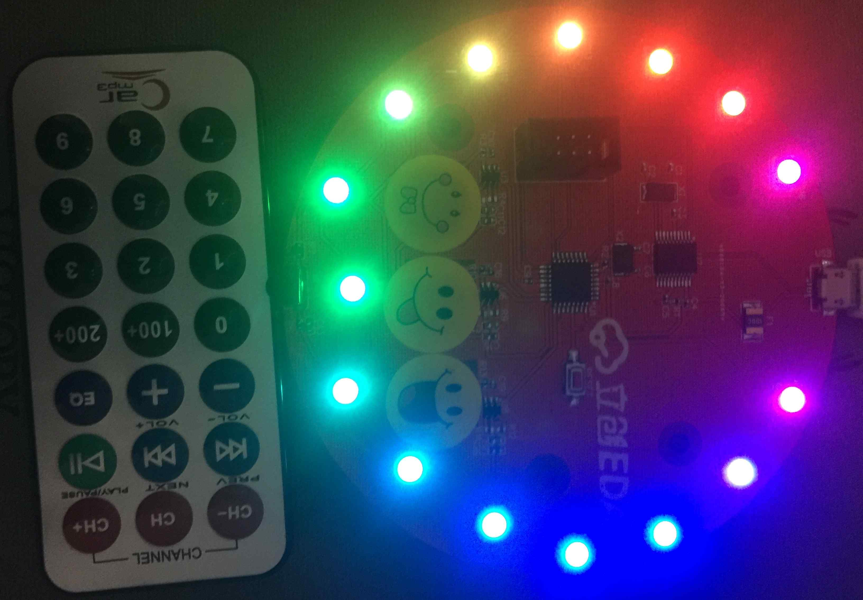

Function description:
Plug in the 5V power supply, and the marquee effect will turn into a rainbow light effect as a power-on self-test. After five seconds, LED09 enters a slightly bright state as a standby indication.
Press the ON/OFF button, all RGB lights will display white with a brightness value of 220 and be used as lighting. + - keys can adjust the RGB white display brightness value from 0-255. Press the ON/OFF button again, and the RGB light will complete a circle with a marquee effect and enter the breathing light standby state to wait for the next start.
The remote control can be used to switch between various programmed marquees, breathing lights, rainbow lights, and various single-color lighting effects. When necessary, it can be used to remotely switch lights on and off, and switch lights on and off regularly. Other functions need to be developed...
In order to prevent short circuit damage to the power supply USB, a self-restoring fuse resistor is connected in series to the USB power supply line. To prevent interference, the USB signal lines and serial port signal lines are routed in differential pairs, and the bottoms of the two chip clock crystals are cleared. The clock is dealt with all around.
