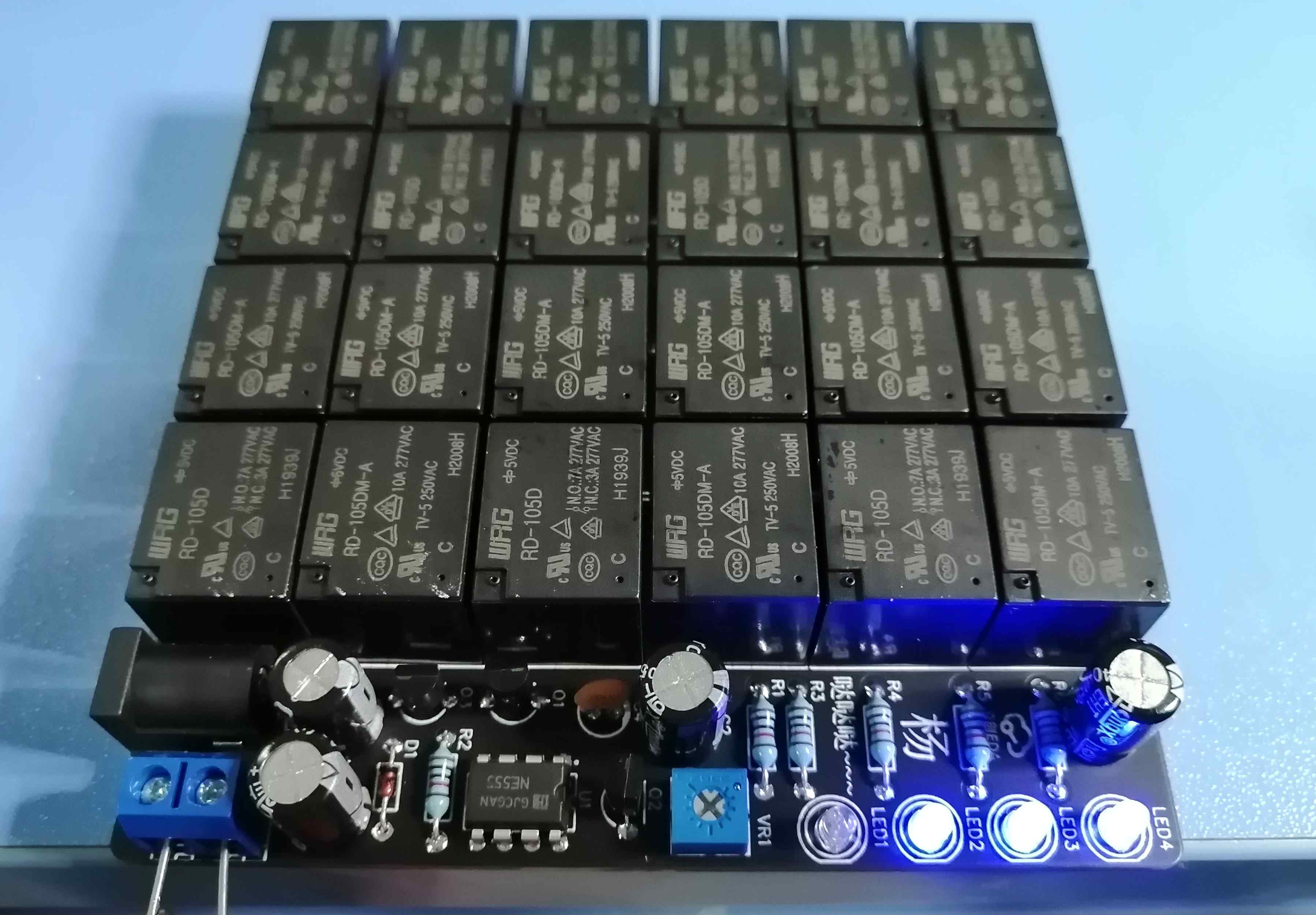

Are you having a headache because of the number of relays?
This project helps you solve it.
Even the clock signal is made of relays. There are 25 relays in total, which just fills 10*10.
Prepare materials
Solder the resistor and diode first
led
Transistors and chips
Tall components
relay
Backside solder joint
Since the power supply of ne555 and the relay are not separated, and the relay uses 5V (larger current at the same power), the 555 oscillates unstable. Connecting pin 5 to ground with a capacitor, and connecting the input in parallel to a large pond did not improve much. Only by increasing the power supply to 7.5V did the improvement improve.
