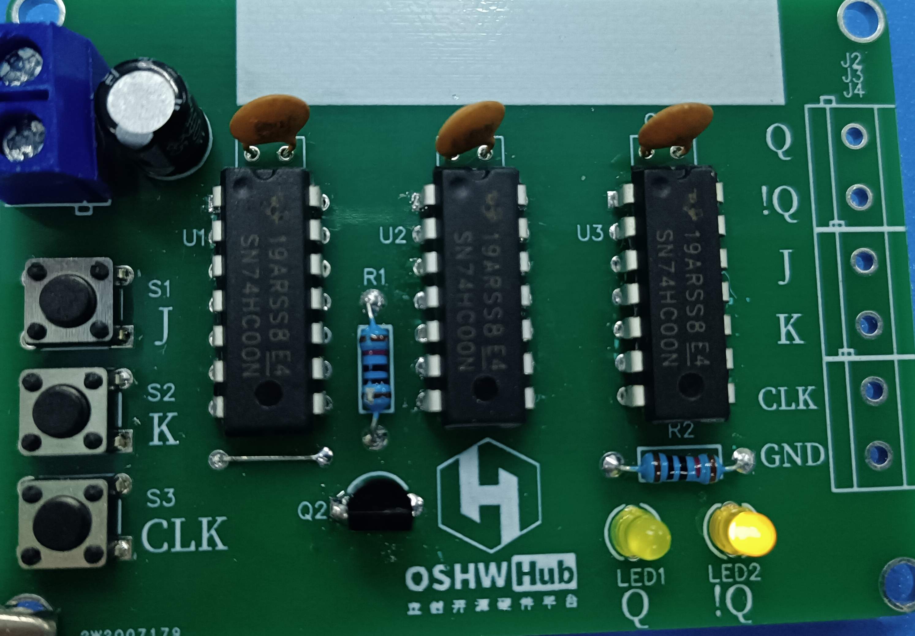

working principle
Pressed is 0, not pressed is 1. You can verify the function against the truth table below.
Compared with the synchronous RS flip-flop, the output uncertainty state is changed to output flipping.
This circuit is for teaching purposes. Finally, each board can be connected together.
The peripheral wiring can be modified to make: asynchronous counter, synchronous counter, shift latch.
Teaching case: video of relay clicking .
Note: If you use 74HC00 instead, remember to add a pull-up resistor to the floating input.
