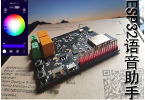

Why choose esp32? Because I think it has powerful performance, dual-core architecture, 240MHZ main frequency, strong computing power, and supports me for offline speech recognition.
This project does not use additional speech recognition modules. It only collects sounds with a microphone, and esp32 is used to parse and analyze the audio data.
The pit of the board
This is my first time to draw a board that was produced as a sample in the factory. I am really grateful to Lichuang EDA for providing such a good platform. I learned that strong electricity cannot be deposited with copper, etc. It's really because I'm not very skilled. I originally soldered on 5 lights, but two of them turned on. I took apart the remaining three. Maybe I broke them, so I changed the positions of the three lights. It still wouldn't light up, so I finally dismantled the last three lamps and will replace them later.
Hardware design
1.Main IC
1.ESP32-WROOM is a 32-bit chip developed by Espressif, with built-in WIFI, Bluetooth, 240HZ main frequency, etc.
2.MSM261S4030H0R A microphone with I2S interface for voice input
3.CP2102N-A01-GQFN28R a USB download chip
4.WS2812E 5 LED lamp beads (mainly considering that esp32 has a built-in RMT transmitter, and the waveform sent just meets the timing of WS2812)
5.AMS1117-3.3_C347222 5V to 3.3V
6.HK4100F-DC5V-SHG relay
There are many more that I won’t list one by one.
2. Overall framework of hardware
The main controller of the entire board is ESP32.
GPIO18 generates RMT waveform and sends it to WS2812, thereby lighting up the LED light.
GPIO32 33 25 is the I2S interface of esp32, which is connected to the pin corresponding to the microphone.
GPIO4 16 is connected to the relay to drive strong current
GPIO0 EN pin is connected to two external keyboards
The rest are some download circuits and power supply parts

Say: Hi Lexin, when you enter the wake-up mode, the LED light will flash in the form of a breathing light, indicating that you have entered the voice monitoring mode. Say the command to control the development board. If there is no response within 5s, restore the previous state and re-enter voice monitoring. model.

Mobile phone distribution network
Creating products on the Alibaba Cloud Life IoT platform specifically refers to the set of processes. One thing to note here is that when using this tool to configure the network, you must choose one-click network distribution.
Then configure the network by scanning the QR code. The entrance to the QR code is here. Scan this QR code to configure network with one click
After the network configuration is completed, you can see this on your mobile phone and you can control it with your mobile phone.
Practicality
I think that later on, I can buy a lampshade to cover the board and put it on the table. The relay can be connected externally to control a fan or something.
This does not completely rely on the network. When the network is disconnected, it can be controlled offline, which is convenient for users. I will add OTA upgrade in the future to achieve remote upgrade.
