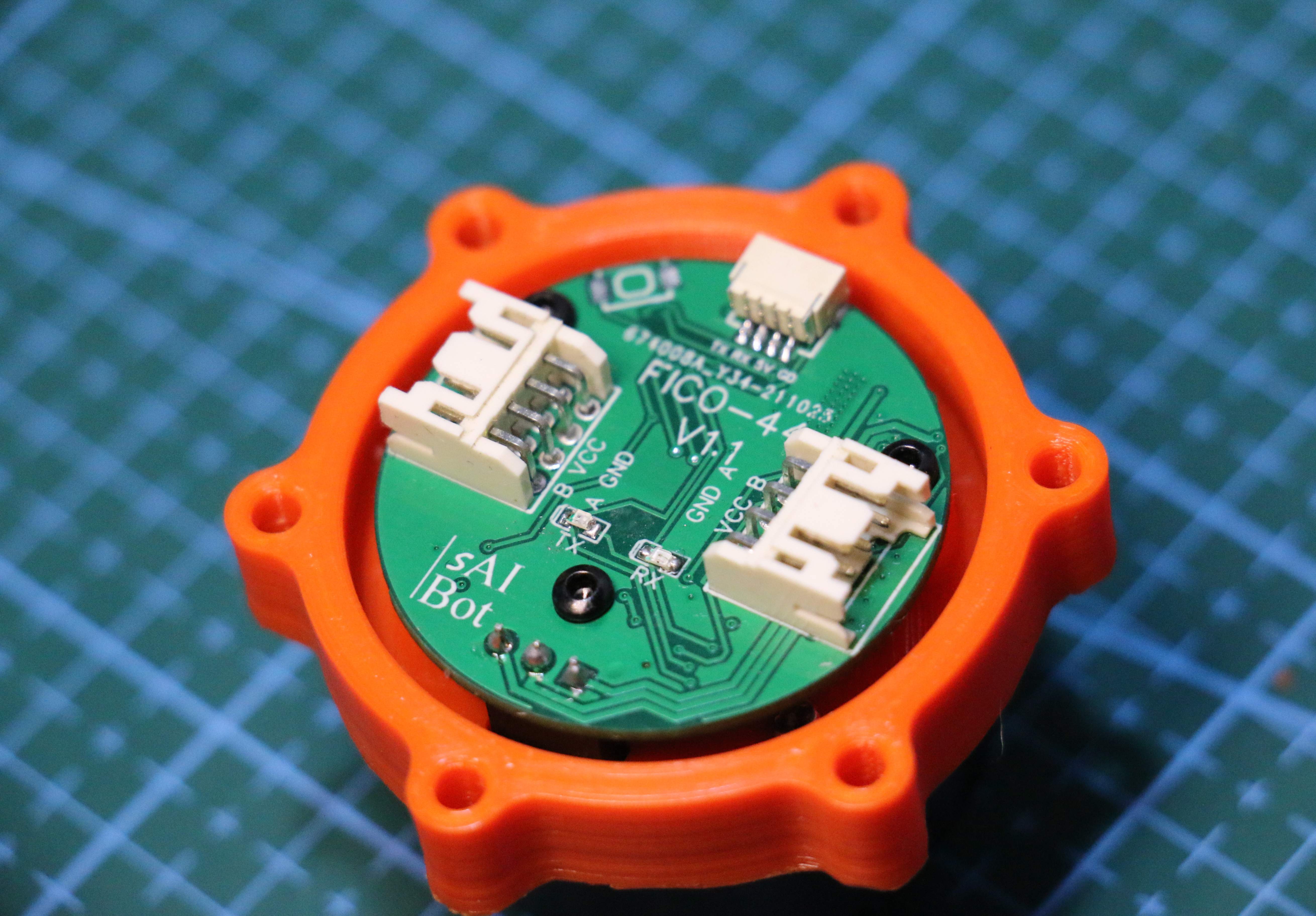

Joint motor based on SIMPLE FOC, DRV8313 driver, AS5600 magnetic encoder, LGT8F328P master control, supports RS485 communication
Introduction video: https://www.bilibili.com/video/BV1Yh41147wo/
Features:
- BLDC FOC (no current loop) control based on SIMPLE FOC, the control board integrates control, drive, and encoder;
- The material cost of a single joint is about 80 yuan
- Using an integrated two-stage planetary reducer, the reduction ratio reaches 30;
- Except for bearings, screws, and nuts, all structural parts are 3D printed, which greatly reduces costs.
parameter
Rated voltage: 16V
Rated power: 25W
Maximum torque: 1N·M (estimate, the error may be large)
Maximum speed: 80RPM
Peak current: 2.5A
defect
- Lack of current loop makes it easy to run away during high load and fast movement, resulting in poor usability of the current version. We are considering a solution to keep the cost from rising significantly
- when 3D printing the gears and ring gears of the planetary reducer, the lack of accuracy of the printer leads to assembly problems or excessive resistance during movement. Using ENDER-3S printer and PLA filaments, the yield rate is higher and the friction is acceptable when the printer is adjusted to a good state.
hint
- The 3D printed model needs to be dynamically adjusted according to the printer model and status before outputting the STL file for printing. The interference fit and gear transmission
