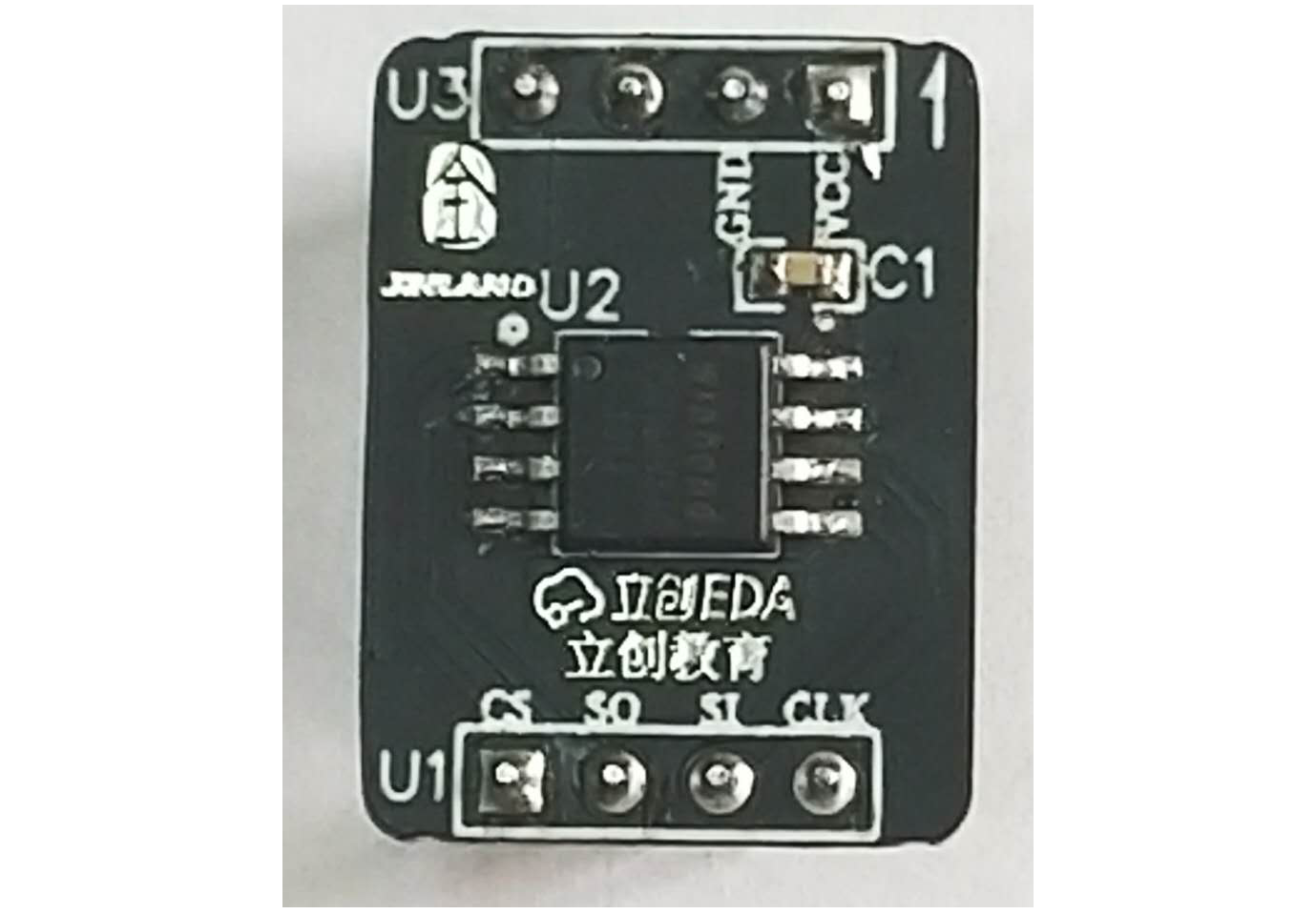

  • PCB photo:
  • Will update in the future - photos of the actual welded product Picture 3.png
  • Dimensions: Picture 1.png
  • Pin definition:
  • VCC: The power supply voltage of this module is 3.3V, which is powered by the development board;
  • CS: Chip select input of the module, which can enable or disable device operation;
  • SO: data output;
  • SI: data input;
  • CLK: Serial clock input, providing the timing of serial input and output.
  • GND: power ground
  • Package size diagram: Picture 2.png
  • Note: When using and installing this module with the development board, please note that the direction of the arrow marked on the board is consistent with the marking on the development board. Inserting it backwards will cause the module to not work or even burn the chip on the module.
