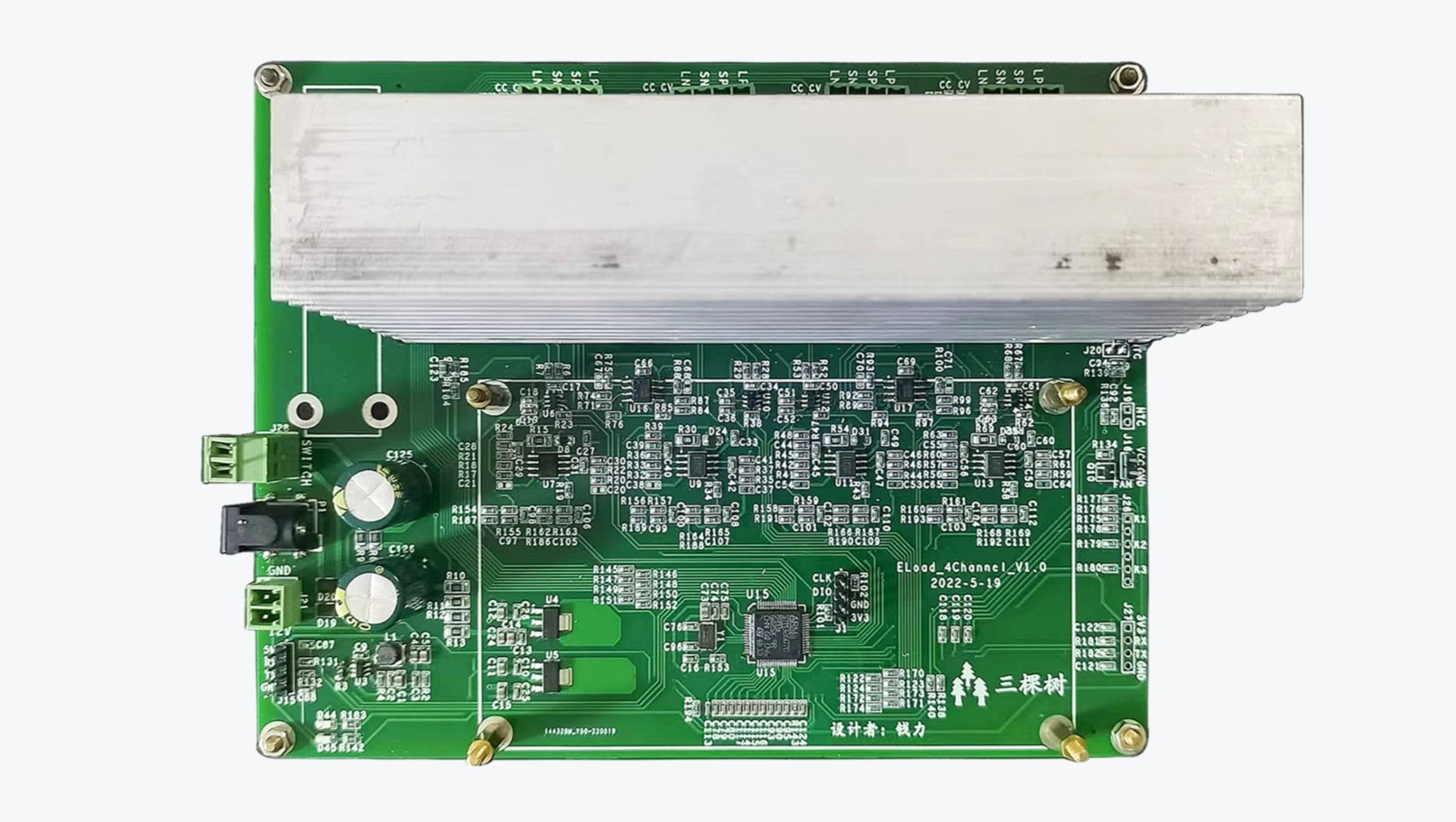

A multi-functional four-channel electronic load/battery capacity tester. Full touch screen operation, multi-parameter display, each channel can be set and operated independently.
2. Application scenario
power supply performance test, aging test, battery, power bank and other capacity tests, and use the battery according to its capacity.
3. Product Overview
The main control is a low-cost four-channel electronic load implemented based on STM32G070 MCU. Use internal built-in ADC sampling. PWM filtering serves as analog reference.
The load in constant voltage and constant current modes is adjusted by hardware, and modes such as constant resistance and constant power are adjusted by software.
The four channels can be set independently. There can be a maximum voltage difference of 1V between each channel.
4. Product parameters
The main parameters and performance are as follows:
1. Integrated four-channel electronic load/capacity tester
2. The maximum current of each channel is 3A and the voltage is 6V. Single channel full power 18W (maximum 25W). (The BOM and firmware can be modified to modify the range)
3. There can be a voltage difference of 1V between each channel to solve the problem of multi-channel output ground current direction.
4. Supports constant voltage load, constant current load, constant resistance load, and constant power load.
5. Support capacity AH, energy WH, running time, voltage, current, power and other parameter display.
6. Support temperature control intelligent fan control.
7. Support constant voltage or constant current mode indicator light display.
8. 4.3-inch serial screen display and setting parameters, touch screen control.
8. The graph curve shows the discharge trajectory.
9. 1% accuracy without calibration, 0.2%-0.5% accuracy after manual calibration.
10. The firmware is still being upgraded, and other functions will be expanded~~~
System parameters:
external 12V power supply, maximum current 0.5A.
The PCB adopts a double-layer board structure. Components
with dimensions of 18cm*14cm
adopt a single-sided layout.
