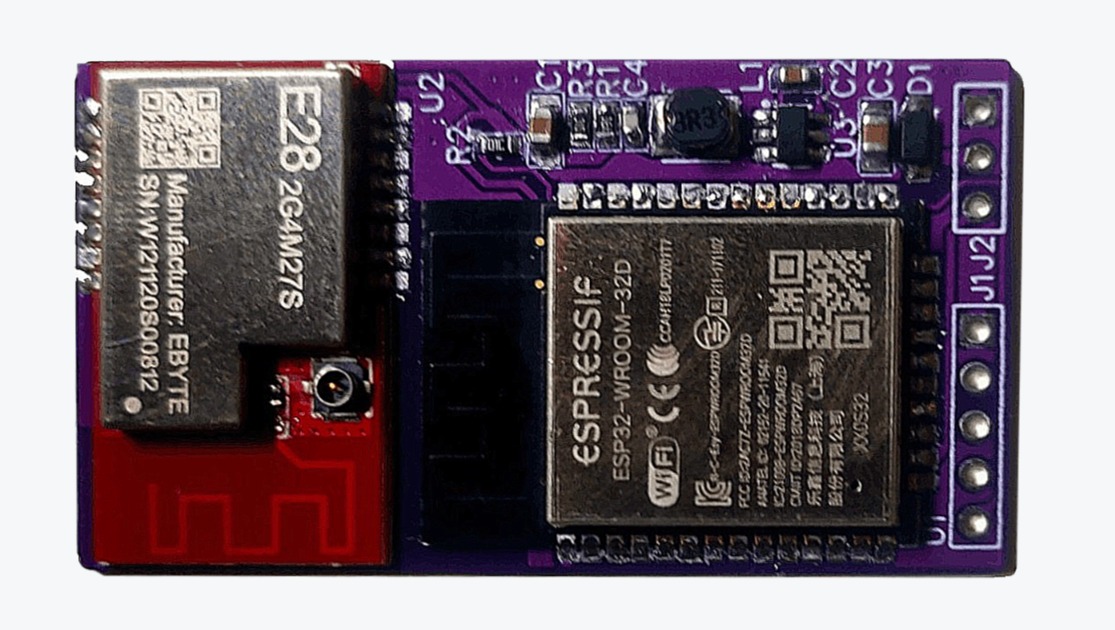

5. Instructions for use:
The 5P interface at the bottom is the program burning interface, and the 3P interface is the remote control CRSF signal input interface.
Back of main control
Front of main control
6. Note:
If you use an external antenna, you need to jumper the resistor on the edge of the IPEX base to the other end, and the antenna must be connected before powering on, otherwise the LORA radio frequency module may be burned out.
The antenna and adapter cable are not included in the BOM.
