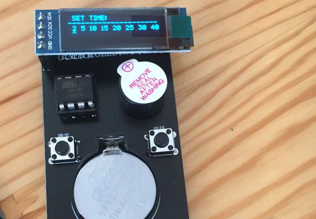

Simple Attiny85 timer: cheap cost, simple operation, few components, easy to weld
OLED screen size 0.91, powered by CR2032 button battery
The minimum timer is 2 minutes and the maximum timer is 40 minutes. Once the time is up, the buzzer will sound every second, which is very interesting.
Attiny85 is programmed using Arduino IDE software, and Arduino uno is used as the ISP programming board.
