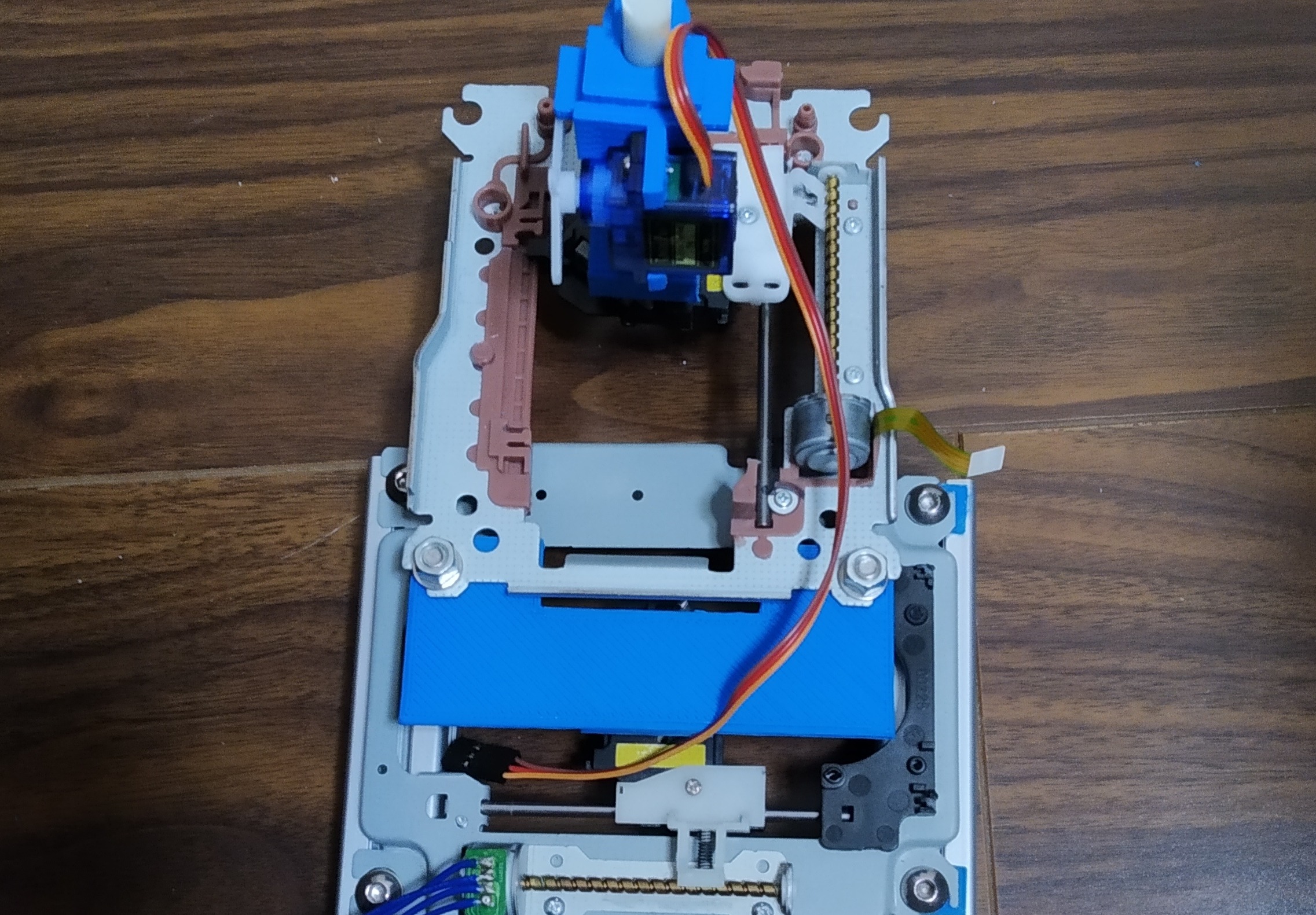

* Briefly introduce the work: Using a micro screw platform to achieve 2D graphics drawing.
[Please fill in during the competition stage↓]
* 1. Details of the work;
This work uses a micro screw from a discarded optical drive to build an X/Y axis platform, and the servo controls the pen to move up and down to achieve 2D graphics drawing.
After the SVG file is converted into GCODE by software, it is sent to the Arduino Nano through the serial port, and the Nano implements the movement operation of the G code.
The X/Y axis is controlled by two micro stepper motors and driven by L293D. The up and down movement of the pen is achieved by using PWM to control the servo.

Hardware part:
The control unit uses arduino nano, the motor drive uses L293D, and the servo is controlled by the control unit pwm.
The mechanical part is printed by a 3D printer, and the stl file is attached.

(1) Two micro screw platforms disassembled from optical drives.
(2) 1 Arduino nano, 2 L293D driver chips, 1 PCB.
(3) 2 30cm 2020 aluminum profiles.
(4) 1 9G servo and accessories.
(5) 3D printed parts and screws.
