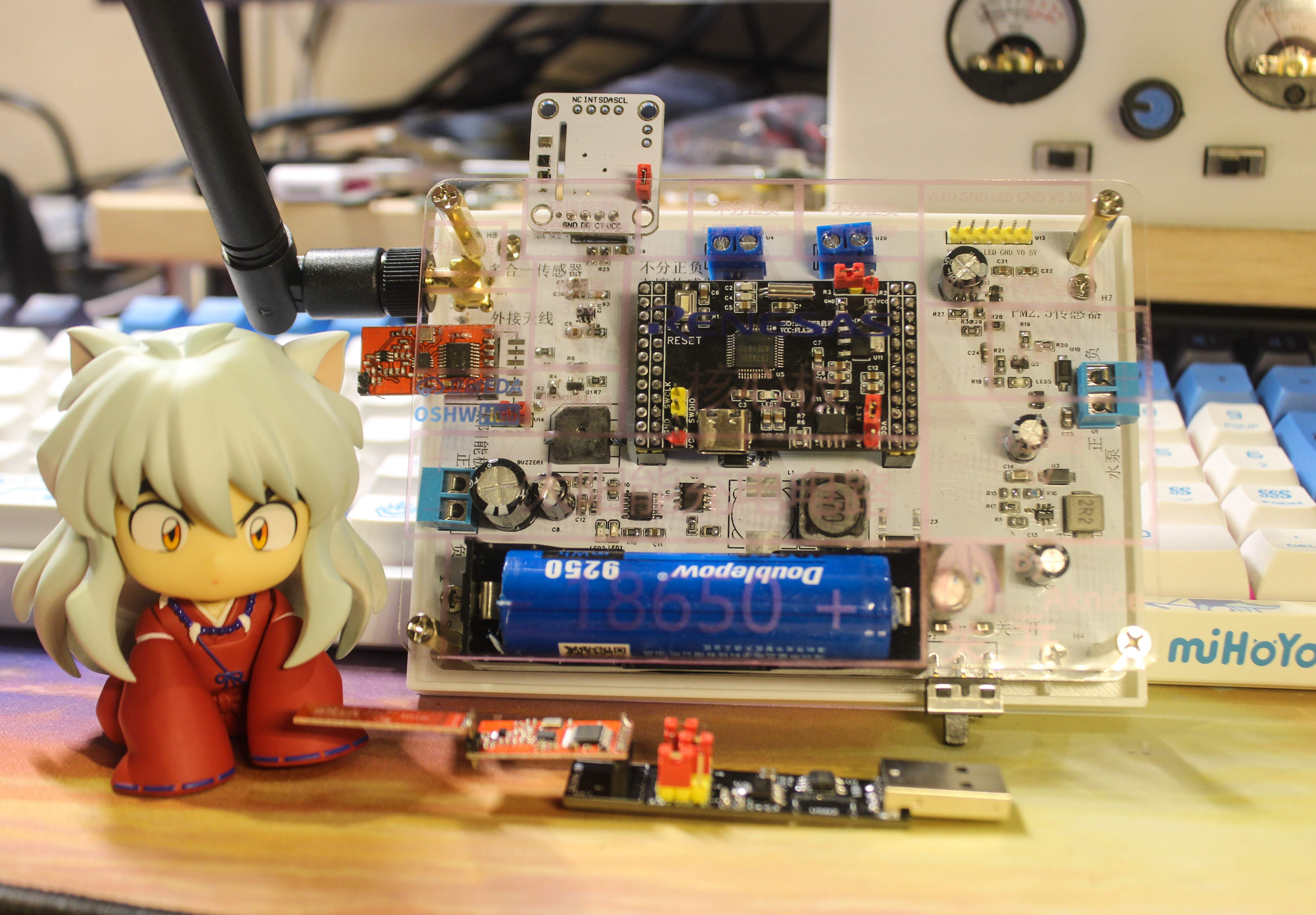

2. Introduction
Based on Renesas' R7FA2E1A72DFL as a slave MCU, it collects the soil humidity, air temperature, air humidity, air rain volume, atmospheric pressure, altitude, and PM2.5 of the farm environment, and can pass these collected data through LC12S (100 meters ) or Ling TR (1000 meters) is transmitted to the host. The host can view the current (data is tentatively scheduled to be transmitted once every 30 seconds) environmental data through the data collection application developed by LabView, and make a trend chart, with water pump irrigation. , has a solar charging circuit, which can achieve self-discipline and unmanned management, without the need for external power supply and external transmission cables. It can be used for weather forecasting of small weather stations, agricultural irrigation and other purposes.
3.Block diagram
I drew a block diagram by hand before, and the project was huge. The actual block diagram is as follows:
3.1 Breakout board
The entire system is planned to be divided into three boards. One core board is the smallest system board with RA core MCU and comes with a USB to UART download circuit. A receiving board, plugged into the host computer, is used to receive data. A base plate on which the system power supply and sockets are located. The advantage of splitting the board is that even if the base board is drawn wrong or the IO needs to be replaced, it is more convenient. The core board can be moved to the next base board.
3.2 System power supply
The 18V solar panel is directly connected to the solar charging chip. The solar charging chip charges a 18650. From the battery diagram, I know that I used two TPS79333, one is dedicated to the MCU and LC12S (100 meters) or Ling TR (1000 meters). The power supply is 3.3V, one is used to power the sensor, so that the sensor is powered only when the sensor is needed, saving power. It is worth noting that the PM2.5 sensor requires 5V power supply. It and the water pump share the 5V from the SX1308 boost chip. The buzzer directly uses the 18650 power supply.

5. Receiving board
5.1 Schematic and PCB
The receiving board is also very simple, with only a USB to serial port circuit and a 5V to 3.3V LDO, mainly with reserved jumpers.
The CS pin works at low level, and is in sleep mode when it is at high level or floating.
SET pin low level configuration mode, high level working mode
How to configure it is described below.
5.2 Precautions for welding
The receiving module has reserved pads for direct soldering and 2.0mm HDR mother pads. It is recommended to solder 2.0mm HDR.
USB-C is reserved and does not need to be soldered.
5.3 Welded finished product
The receiving board also requires 3 strip line caps for configuring the working/configuration mode and working/sleep mode, as well as the power supply of the transceiver module

8.底板与各种元器件的接线
接线一览
亚克力另需六角铜柱 M3*25 4个
8.1核心板
直接插入pin对pin
8.2电池
18650锂电池,左负右正
8.3传感器
GY-39 pin对pin
pm2.5传感器杜邦线连接
雨水和土壤传感器杜邦线+301座连接,不分正负
8.4天线
外置天线SMA-KE座连接,无线模块插入2.0mm母座或直接焊接(推荐母座,方便拆卸)
天线焊盘需要连接到模块上
8.5水泵
上负下正,注意电源不要接反
8.6太阳能板
301座连接,上正下负,不要接反

15.实物图
裸板
外壳+亚克力+所有元件接入
16.实测
