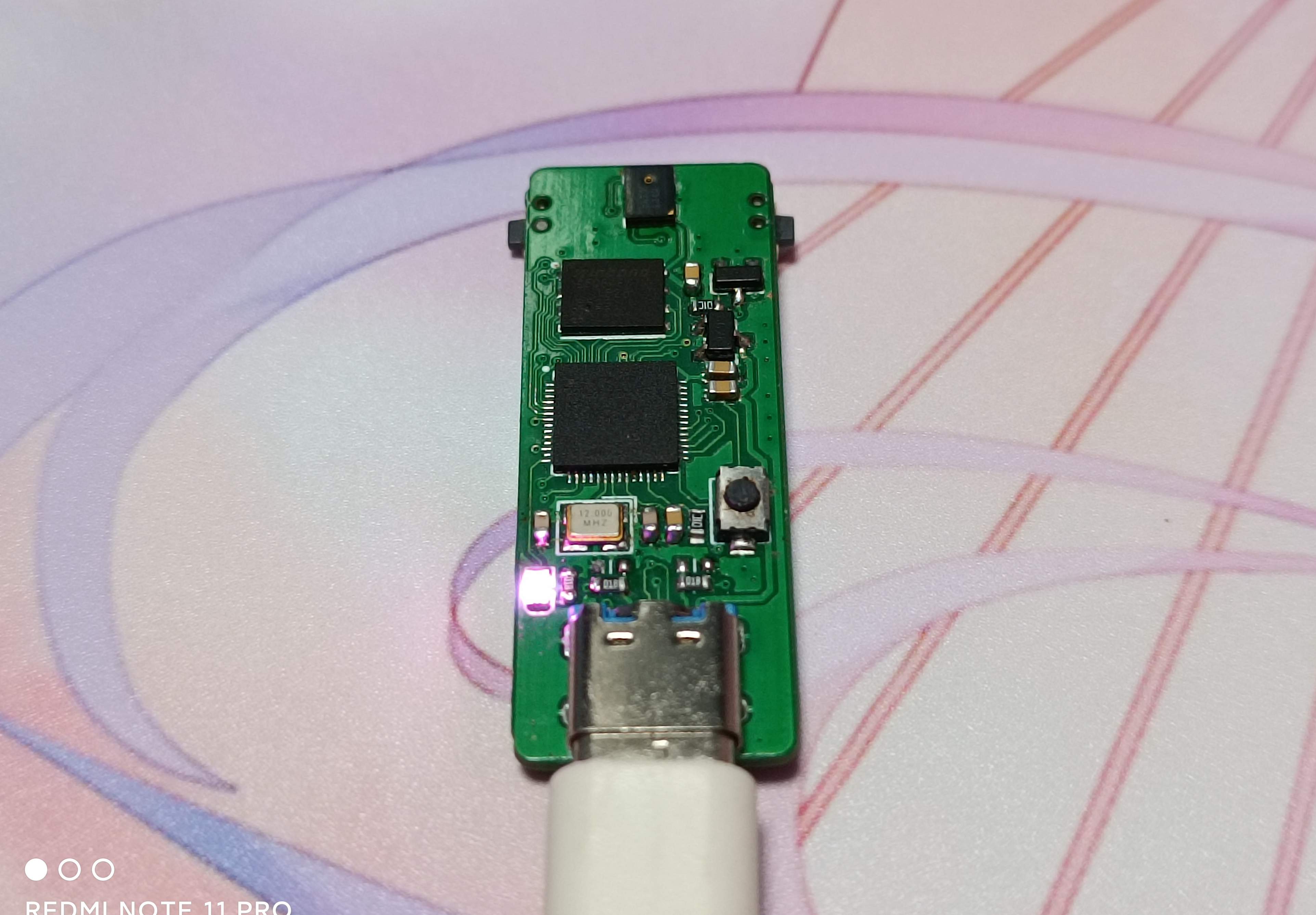

Cube-440_hardware voice changer
Mono 16bit 48Khz USB microphone, while processing the audio signal to a certain extent
(Because the RP2040 runs FFT too slowly, audio processing will be implemented by binding the host computer (Curve to save the country╮( ̄▽ ̄)╭
Q group 565264047 Welcome to play~
If you need cooperation, please contact the email root@an-ye.top
UAC2.0 protocol, Windows/Linux basically does not need to install drivers
Starting with version 1703 Windows 10, the USB Audio 2.0 driver is shipped with Windows. It is designed to support the USB Audio 2.0 device class. The driver is a WaveRT audio port class miniport.
The performance is okay, but there is an inexplicable low-frequency noise, about 20HZ. Anyway, I won’t deal with it if I can’t hear it.
Firmware open source repository: " https://github.com/panyihang/Cube-440 "
Being updated, the code is not perfect yet, though. . . It’s not that it can’t be used (everyone is welcome to suggest PR)
