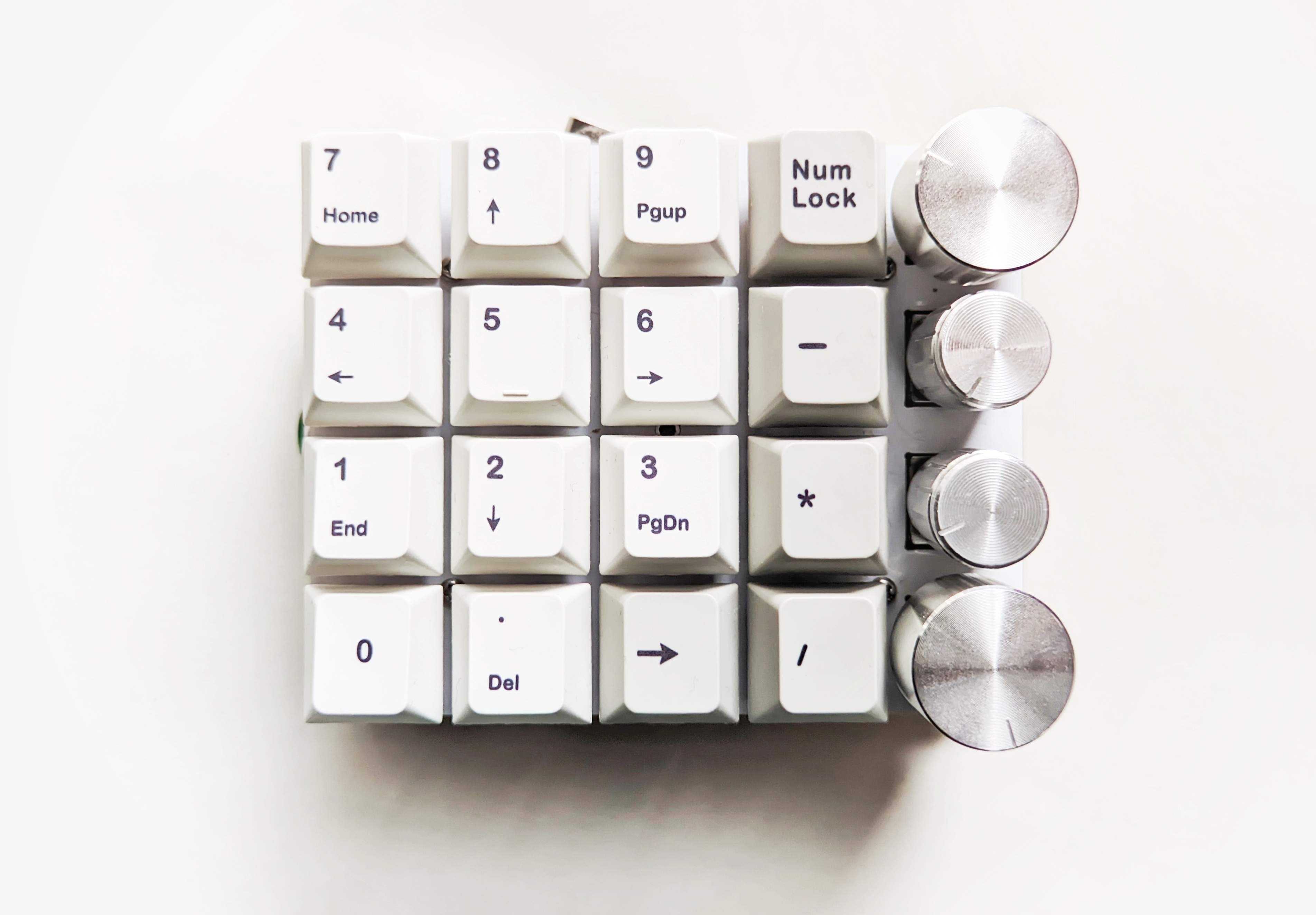

Fake split keyboard (orthogonal)
Dimensions (unit: cm)
name | long | Width |
PCB | 9.525 | 7.62 |
Positioning plate | ||
base plate |
material list
serial number | Essential | name | quantity | Remark |
1 | ✓ | 1N4148 plug-in diode | 20 | |
2 | ✓ | Shaft | 16 | |
3 | ✓ | Kaihua hot-swappable shaft base | 16 | |
4 | ✓ | EC11 encoder | 4 | Plum blossom handle, height optional |
5 | ✓ | knob cap | 4 | Plum blossom handle, random height, width 15mm (the two edges can be 20mm higher) |
6 | ✓ | Pro Micro Development Board | 1 | Buy one that comes with BootLoader |
7 | △ | 12pin pin header | 2 | It is used to connect the development board and PCB. It is usually given when buying a development board. |
8 | △ | 40pin header | 1 | It is convenient to disassemble the development board; cut it into 2x12pin for use; if you use a female header, you need to buy the corresponding pin header, or use the cut diode pins |
9 | ✓ | Positioning plate | 1 | |
10 | ✓ | M2 screw | 10 | 5 holes on the positioning plate + 5 holes on the bottom plate, recommended heights 5mm and 10mm |
11 | ✓ | M2 nut | 5 | Height 10 mm or more |
