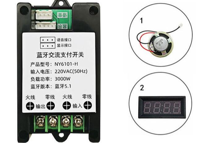

3.1 Scan code to pay socket (applicable to devices that control 220V electricity)
3.2 Scan the QR code to pay for children’s cars (applicable to equipment that controls DC power)
