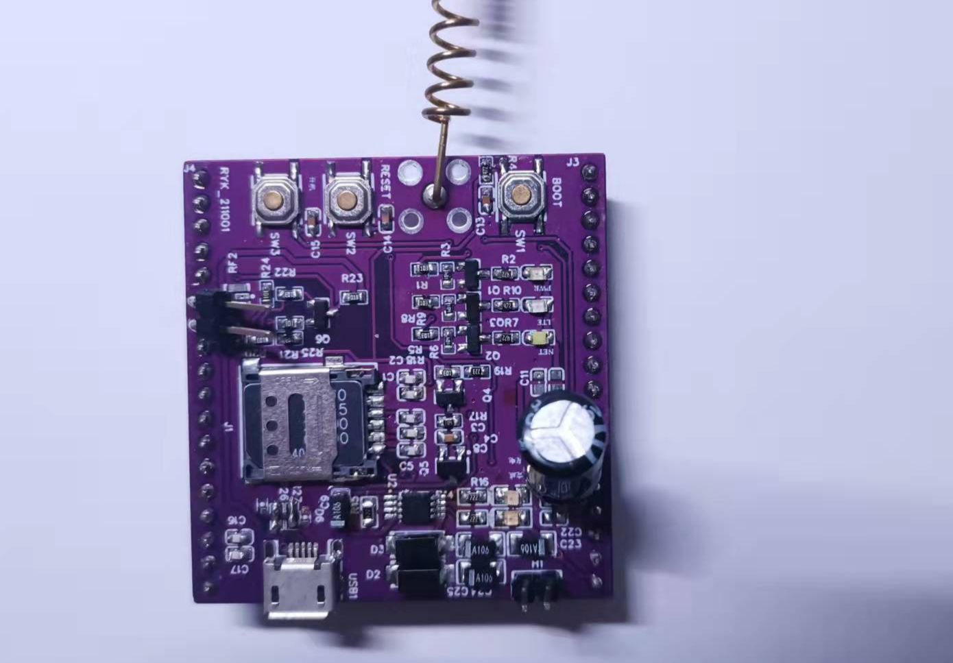

     1. Hardware design
      Hardware is the core of system implementation, involving hardware design and Air724UG module program development.
     The hardware part includes the Air724UG module core board.
     Functions include: 4G module core board, 4G, 5V power supply, lithium battery charging, lithium battery power supply SI network indicator light, etc.
     The hardware part includes Air724UG measurement and control baseboard
       Functions include: Ruyikong measurement and control backplane, optocoupler isolation relay, sensor, LED light, temperature sensor, ADC acquisition potentiometer, etc.
