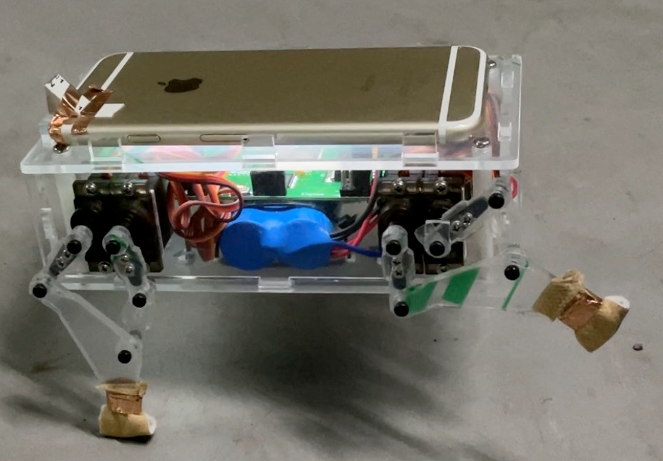

  • Robot dog with 4G remote control based on HI3861
basic skills
  • The robot dog can move forward, backward, left, and right, and can make various actions based on the rotation angle of the servo of each leg.
  • Remote control and real-time audio and video calls using mobile APP
  • Use watch APP gestures to control the walking of the robot dog
Hardware parts
circuit board
  • The main control uses Hongmeng HI3861 and PCA9685 for multi-channel servo control.
  • The circuit is drawn according to the training camp course. In order to facilitate the control of battery power, a boat-shaped switch pad is added.
shell
  • Shell reference training camp course content is designed using SW
  • In order to facilitate the placement of mobile phones, the tops of the front, rear, left and right baffles have been partially raised.
  • In order to install the boat-shaped switch, a rectangular slot was opened at the bottom, but the thickness was not considered, so the boat-shaped switch was not installed particularly firmly.
other
  • An old mobile phone is placed on the back of the robot dog to provide audio and video calls and network hotspots
  • In order to capture the front view when the phone is laid flat, a prism is added to the camera position of the phone to change the angle of the light.
  • Dog feet are covered with band-aids to prevent slipping

Finished product display picture & attached video
Robot dog overall
