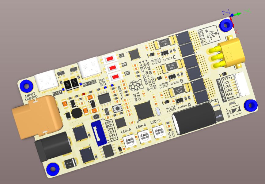

FOC control driver board
Using RP2040 as the main control, the ADC collects three-phase low-end samples
The 6-channel PWM is connected to the H-bridge of FD6288 to drive the motor.
The design current is 30V, 30A. The mos can be replaced to increase the voltage and current, and the PCB traces are opened and tinned to increase the current.
Generally speaking, the schematic diagram and PCB are not a big problem. Let’s try to make prototypes when we have time. .
Already boarded. Unverified.
