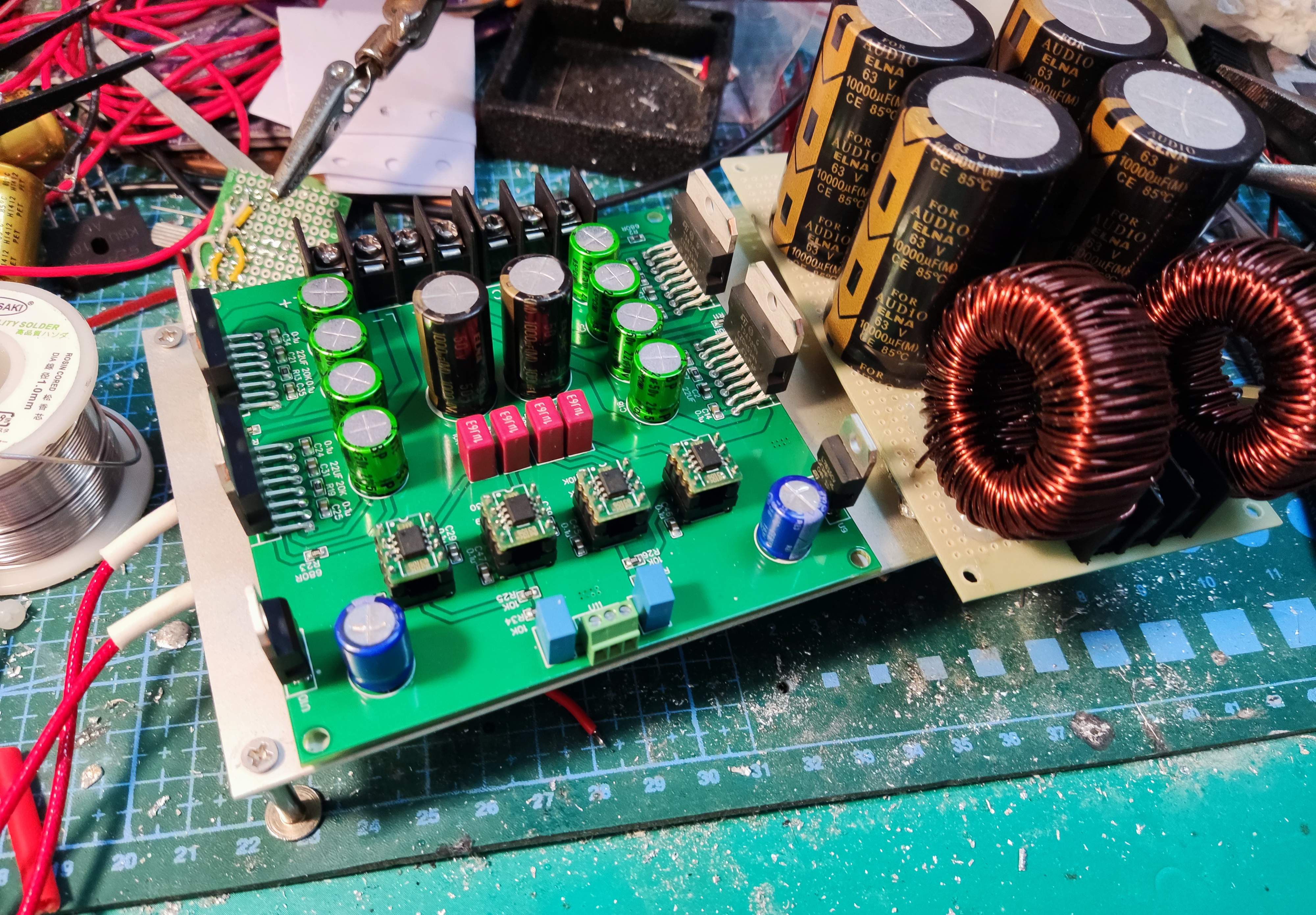

Using ±25v power supply can output up to 100w×2thd at 8Ω, about 0.1 (refer to the data sheet) Using ±35v power supply may allow higher power and lower thd, up to 150w×2
The recommended power supply is ±25v--±30v (I use ±30v). It is recommended to use AC dual 25v or 24v. After rectification by a transformer with a power of 300W, it will be approximately ±35v. The rectification requires at least two 10000uf capacitors (one for the positive power supply and one for the negative power supply). to ensure that the voltage ripple during large dynamic
