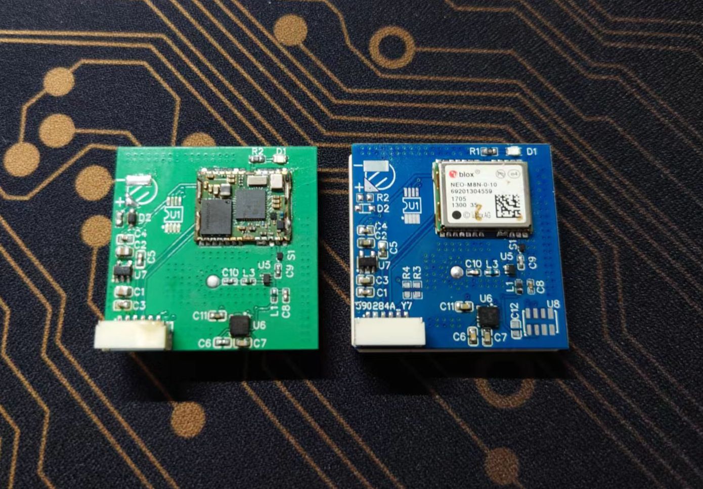

The first version has been board tested
Currently testing version 2
Still for reference only! ! ! !
The GPS module is NEO-M8N-0-10. The imported module has a built-in eeprom. There is no need to weld an external eeprom.
The theoretical calculated value of the RF line impedance is 50Ω. The actual value needs to be measured.
Optional addition of 5883 or 8310 compass, 5611 barometer
Can be used for pixhawk open source flight control
The GPS participating in the comparison test are M8N and M8030
The test method is: cold start at the same location, record the number of satellites and HDOP value of the mp ground station for 60 seconds, the test results are shown in the figure below,
