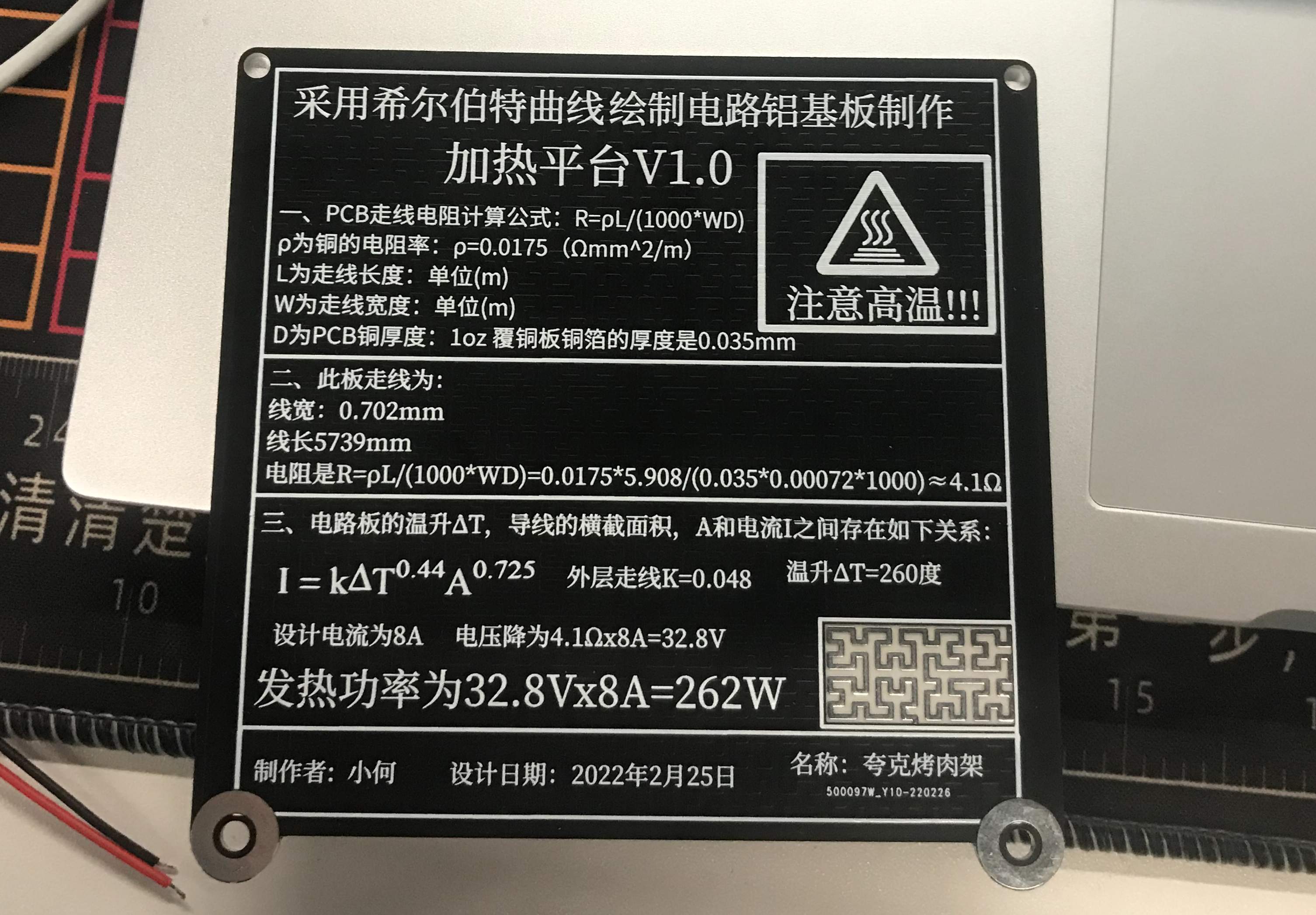

In order not to forget the heating principle of the circuit board, all computing companies specifically wrote about the silk screen layer on the circuit board.
You can clearly see how the circuit board generates heat and the principle of temperature rise.
