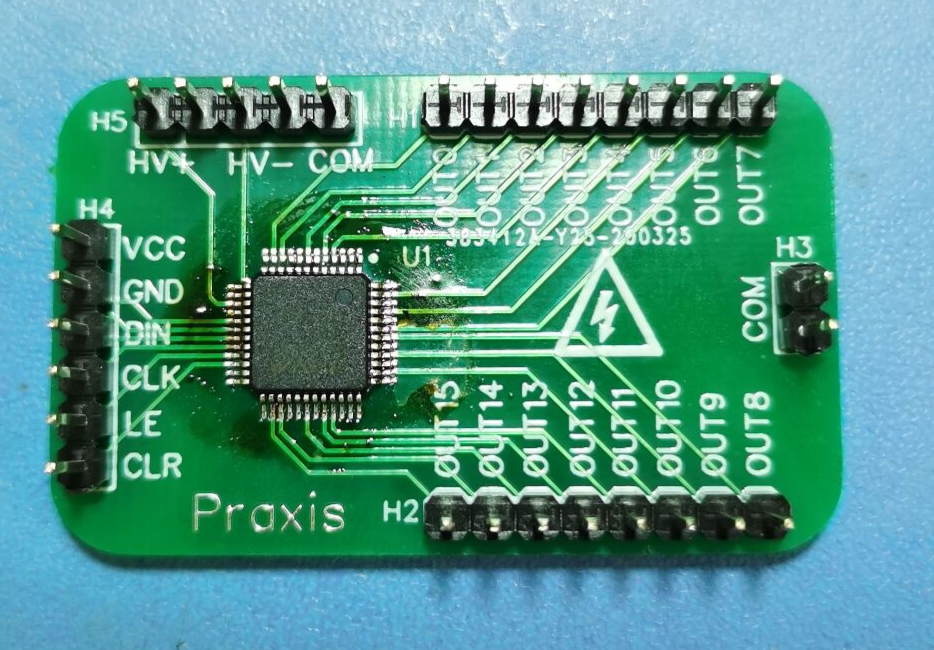

MAX14803CCM adapter board
Adapter board for debugging the MAX14803CCM+T. All the COM pins of the analog switch are connected, and the remaining pins are led out. To prevent short circuit to ground, no copper is laid. Multi-channel ultrasound switcher for installation. ``` void shift_datawrite() { int ks; for(ks=0;ks>ks)&0x01); CLK=1; delay_us(1); } delay_us(1); LE=0;//Data transfer completed, Pulling the LE clock line low allows max14803 to update the content just moved in delay_us(10); LE=1; } ```
