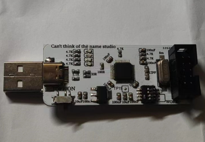

 1. Introduction to project functions.
Reason for design: I want to attend the LiChuang training camp, but I don't have a programmer.
Design concept: NSlink based on N32G455CCL7.
Design features: Adopting "tree-style USB design"
tXMU9UxHDFIFxWX9rvBrYO71TjmV3BwvGMA4qmHN.pngwhile retaining USB-A and USB-C. You can choose one of them according to your own needs when welding.
As an adult, of course I want "both".
The operation method is
to first weld the type-c female port and then plug in the data cable.
Then put the A port on it and stick it to the wire end and
weld the A port fixing seat.
z4Yq2lct244o6J7zXfU25py2X7EfBXG11gkbD6sy.png2. Project properties
. This project is based on the N32G45XCL-STB development board.
3. Open source agreement——
...​​​​​​​​​​ The firmware is provided in the attachment. Open the nations mcu download tool and you can complete it here. 6. The BOM list is shown in the following table. WARNING!!!!! ① The USBA port definition is reversed (fixed) ② Pay attention to the welding of the USB interface
