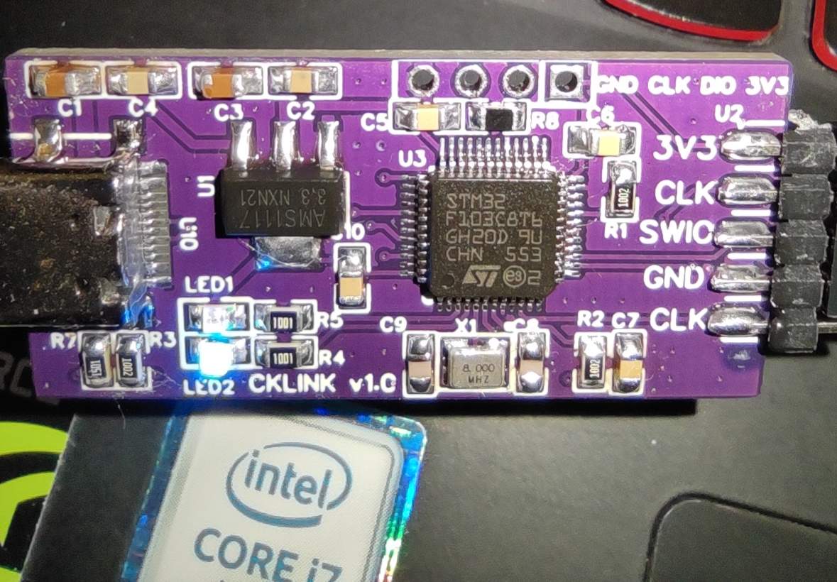

The schematic diagram is not that difficult. I can make one myself and share it with everyone.
There are many 8050 packages made, which is convenient for friends to solder by themselves.
First use STlink to burn the homemade cklink firmware, then configure relevant settings in the software and load the driver.
Please see the video at Station B for details!
https://www.bilibili.com/video/BV1L44y1J7Jz/
cklink firmware CKLinkLite2.30.hex
sdk configuration file W806_Flash_Tool.elf
The new version has rounded edges!!!
