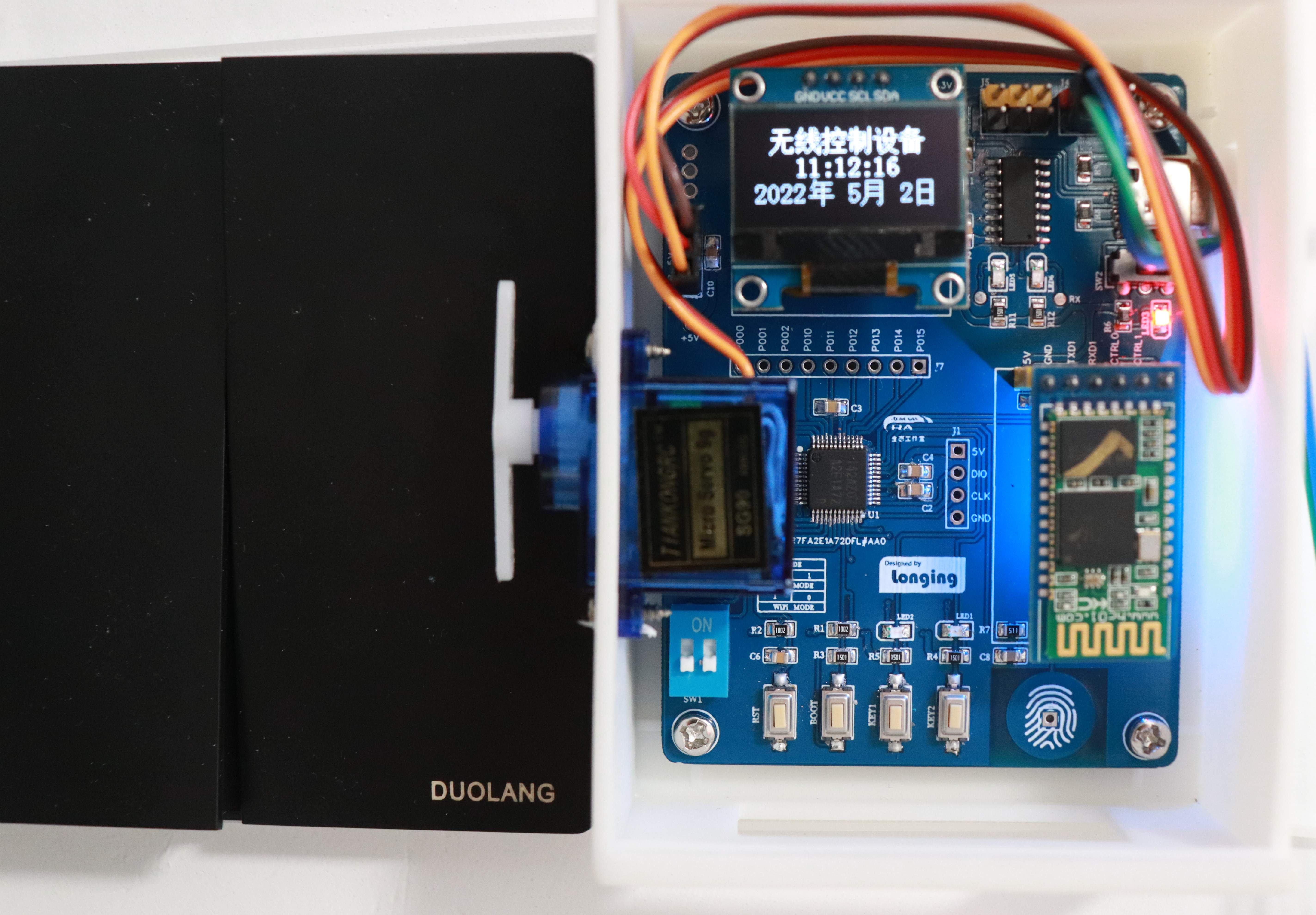

    基于瑞萨MCU的智能控制设备,原理图设计上主要以一个功能板的形式进行开发,预留未使用到的io口,可以方便后续进一步diy,增加自由度;开发板预留透传接口,后续可以选择性接入BLE透传模组或者WiFi透传模组等等;
    本设计一个版本将基于这个功能板设计一个智能控制器,实现本地控制设备的开关(例如开关灯,将传统的墙控转换为智能控制设备,解放双手);
     1、第一阶段,会以离线版本,搭配OLCD显示屏+按键+电机驱动电路,实现本地的定时开关灯
     2、第二阶段,会增加BLE透传模组,实现一个更倾向于低功耗的无线控制器
     3、第三阶段,会接入WiFi透传模组,实现语音、APP控制等。
    会先从第一阶段,进行设计开发,后续会持续更新第二版本,第三个版本,当前设计的最大优势是开发板功能可扩展性较强,三个版本可以使用同一个开发板已经固件进行开发设计,由功能选择模块,进行选择。如有问题或建议,欢迎随时沟通

3. Physical picture
Figure 1 Description of the physical module
Figure 2 Normal work

The 0.96-inch OLED driver IC is SSD1306;
Figure 3 OLED screen Figure 4 Schematic diagram
  1. GND power ground
  2. VCC power supply positive (3~5.5V)
  3. The D0 pin of SCL OLED is the clock pin in IIC communication.
  4. The D1 pin of SDA OLED is the data pin in IIC communication.
4.2 SG90 motor
Here the SG90 motor is driven through pwm
Figure 5 SG90 steering gear Figure 6 Drive pwm waveform

  1. When powered by 5v, the rtc time is inaccurate and an interrupt occurs once every 1 second. However, during actual measurement, it was found that this was not the case. The reason still needs to be investigated.
  2. When powered by 5V, the OLED IIC serial port communication will be stuck, causing the main program to be unable to proceed. At first, we have been troubleshooting the code logic and hardware circuit design problems, but later directly verified on the development board and found that the 3.3V power supply , it can drive normally. This problem is really a headache. If you have friends who have encountered similar problems, you can communicate with them.
