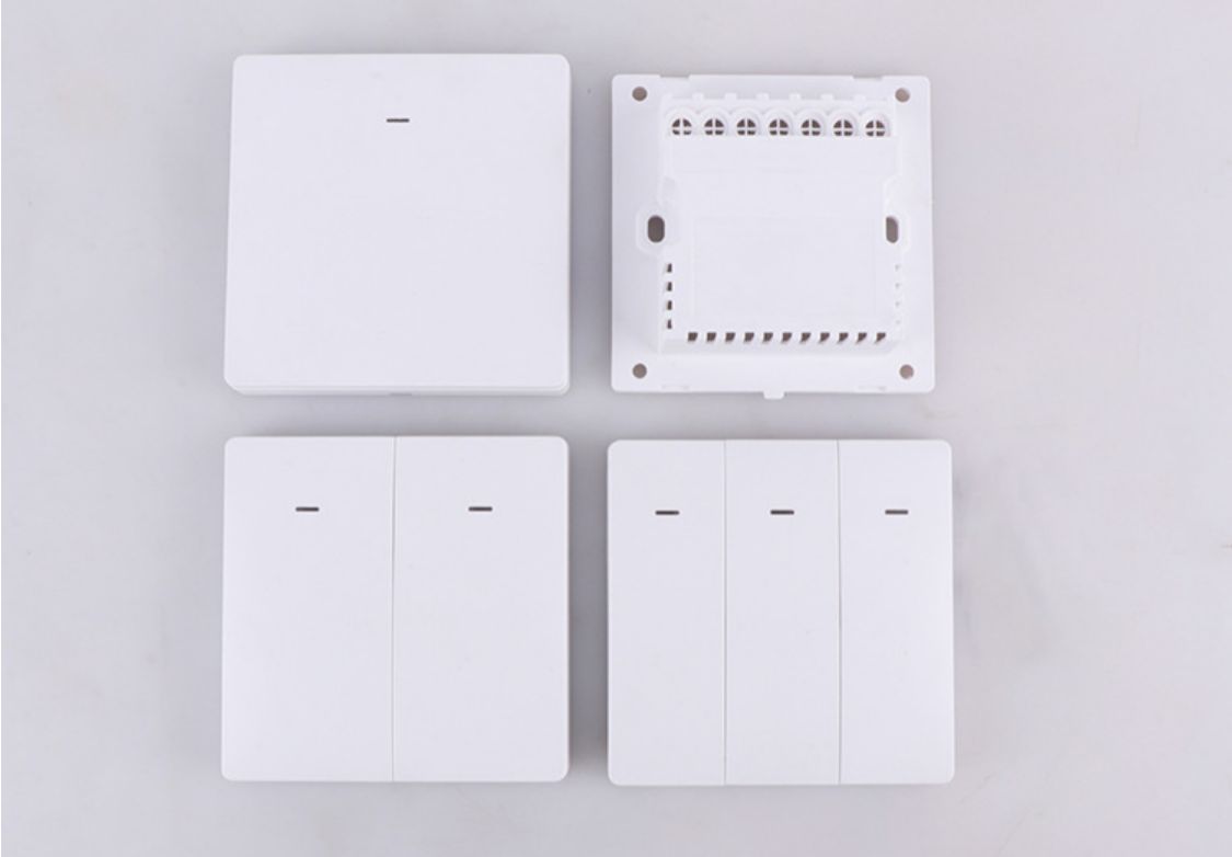

ESP8266 ESP12F 86 box (lower board) smart wall switch
I originally wanted to use the project shared by jack in the group, but some components are inconvenient to purchase, and there are some special customizations. Currently, jack does not have open source circuit boards, only proofing files, so this project was born
Although it is not a very complicated thing, it still requires a little effort to draw the corresponding slot position according to the size of the male mold (it takes a day)
The board has been verified and passed
Explanation of opening one, opening two and opening three
In order to facilitate the sharing of a circuit board, just selectively mount it

Shell purchase address
Factory direct sales of new mechanical type 86 medium-sized smart switch shell male model smart wall plug shell-Alibaba (1688.com)

3D rendering
