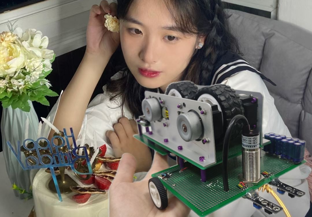

The story starts with this picture
After choosing the energy storage car with power generation function in question I, I drew this soul drawing that morning:
I joked that Guoyi was stable (directly confident)
The two teammates were already laughing when they saw it.
However, at this time, I had already selected all the accessories.
I built the 3D model in the evening:
(First version, later the wheelbase of the driving wheel was changed)

Final product:

Overall solution description
In this design, power generation and driving are divided into two parts, with independent functions. The drive uses a three-phase AC brushless motor.
The weight of the car body is reduced, the power generation capacity is expanded, and the power loss is reduced. In terms of energy storage, supercapacitors are connected in series.
Greatly improves power utilization, the coin detection circuit uses capacitive proximity switches.
It has a simple structure, high sensitivity when identifying coins, and the detection circuit and tracking are both controlled by a single-chip microcomputer. This design optimizes all aspects of functionality to the highest level.
